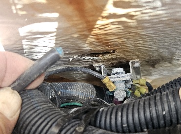

Windlass stopped working in my Rinker 250 cruiser. I have 12v to the breaker switch but when I meter the negative & positive connections on the windlass up/down switch i only get 7 volts. If i transfer negative test lead to independent ground i get 12v so I assume bad ground connection. The negative up/down switch cable has a label to battery. However very hard to trace where it goes & the negative terminals on my batteries go to the engine ground & the hydraulic pump. Any ideas where a windlass negative lead would connect apart from battery. If I can't figure it out I will run a new lead direct to battery.
