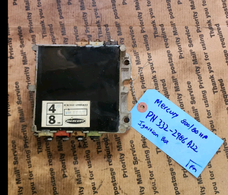

I wish to sell a vintage Mercury switch box from my stock and don't quite understand the marking. It is part number 332-2986A-22. What does the 8 mean? So apparently it will not fit the six cylinder in lines? This is a brand new item I have had on my shelf for many many years. Thanks, Tim
Thanks, Racer. Mercury is quite confusing sometimes to me. I prefer OMC, also interchangeablity.
The only Mercruisers I ever saw with this was 427ci's in a houseboat with TR drives and a old military river patrol boat that had outdrives that could swivel from 90° to 45°.
So that was a Ford? Crazy! In automotive applications, electronic ignition came out in the mid 70's.
Agreed, Racer. So in this case this was only to provide a tachometer signal but did not control the spark electronically? I don't think this subject has much merit today but I have never seen it covered. It's so easy to just hook your tachometer to the distributor side of the spark coil on a points ignition. Why the box?
The way the ignition worked was engineered for Mercury's tach which used higher voltages and rise times. When you bought a motor you could get the tach to go with it which was a better one than a car tach (waterproof, shock proof etc.).
anyone that buys that swichbox can use an alternator driven tach.
Okay, interesting. So what year is the box? One guy on eBay has it listed as a 1969, so its really for 1975/76?
