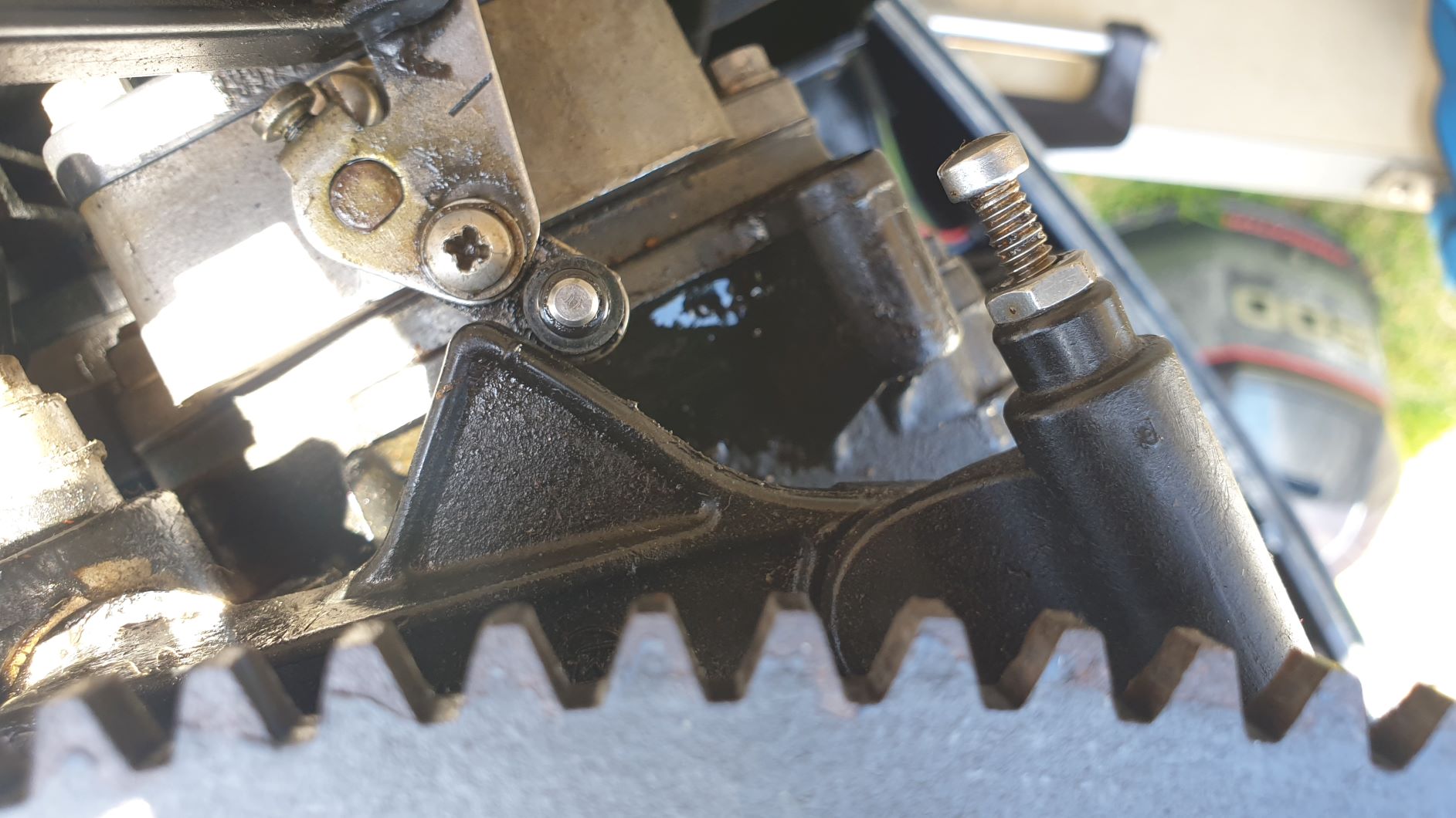

I have a 96 Vindicator which stalls when put into gear. Plugs have been changed, fuel lines cleaned and new filters fitted. Compression is low (appx 85) but consistent across all 6 cylinders.
I have seen some posts regarding the throttle roller, and too large a gap. Is this the throttle roller in this picture?
When I shift, the other part (sorry not sure what it is called, cam?) does not engage with the roller until the shifter is almost all the way down (note, this was with the engine off if that makes any difference?).
Seems like this could be an issue?
If so, are any of those screws shown for adjusting this roller?
Any help much appreciated.
Cheers

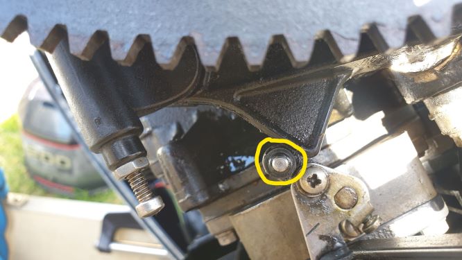

Cheers
