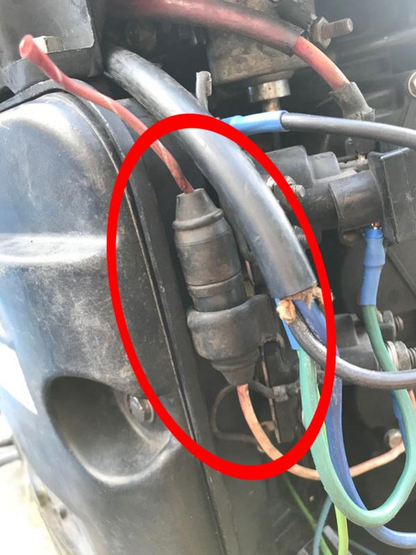

I'm replacing my old motor with another old motor. Both are '86 Mercury 75 HP. Today I wired the tilt/trim.
Next to the T/T solenoids on the 'new' motor is an inline fuse holder with a glass fuse inside (photo below).
Red wire coming out of the bottom was attached to one of the solenoids. Red wire coming out of the top was clipped off.
This fuse is not on my 'old' motor and everything works even though this fuse is not connected.
Is it necessary, and where do I attach the other end?
