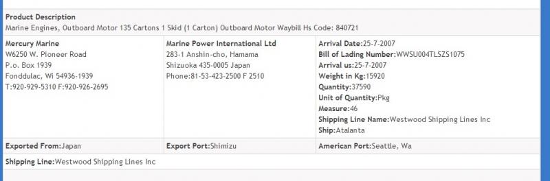

Then we can fast forward a bit to 2007 - long after Merc supposedly cut it's ties with Yami, at least according to their press releases. There is reams of waybills showing what was received by Merc plant 3, the "import warehouse". Now why do you import 135 skids of marine engines when you are producing them "on site" - hmmm, maybe you have to read about the role of plant that receives these blocks and bores the cylinders on site - so if you bore the cylinders does that mean you "made" the motor?
I am really sorry that I have got so far under your skin.
Isn't it just a little bit possible that you were lied to by some rep that either didn't know or didn't want to state that the great American icon "Merc" is just as foreign as most other things on store shelves. And perhaps you should ask him about plant 98, which was the foundry producing flywheels and manifolds, which in 1999 was converted to produce props (which are 100% US made). The foundry was not "moved" it was shut down - hmmmm the plot thickens...

Galamb ...you might reread that waybill as its: 1 skid with 135 cartons for 37590 pieces in seperate packages of something with weight working out at about a pound a piece. The (1carton) notation is because its shrink wrapped.
