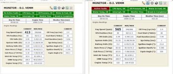

Code 26 was set and and I had a no crank issue that I am sure is the EMM. I am including screen shots of the data to see if you might glean anything from these. (I replaced the EP nipple)

I replaced the EP, and battery voltage was at 12.4 volts. I just noticed 40V circuit was at 31 volts. I was talking to someone yesterday who told me that will affect idle speed as it affects injector firing. I have the EMM out of the boat and will sending it out today for repair.
