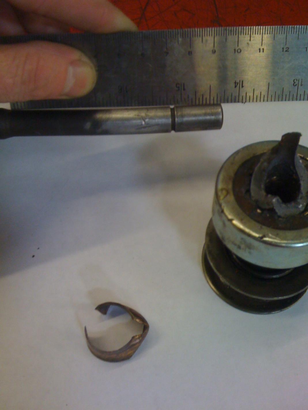

UNRELATED TANGENT: It got better... we moved around, trying fishing a few different spots during the day, then when we decided to call it around 3pm, my brother fired up port, then went to crank starboard... starter free-spooled. He tried again, and it free-spooled again. This time it kept spinning after he turned the key back to off. Tried again, and popped the 50A breaker... sigh... turned out the starter solenoid was shorting out inside and staying engaged. Pulled the starter back at the slip, and the bendix gear was shattered... sigh again... Gonna be fun digging those pieces out of the bellhousing... Just tore down the starter at work today, and the armarture shaft is bent also... What the hell could have caused this? I know the "worst-case scenario", but temps/pressures were good, and I don't even want to THINK about THAT possibility right now! I was in the head and did not notice, but he said it STARTED to crank (he said the tach needle rose up a bit, then dropped as he heard the starter free-spooling). Correct starter, properly aligned... just an old starter had enough? One brass bushing inside is mangled (sits at base of armature shaft).
