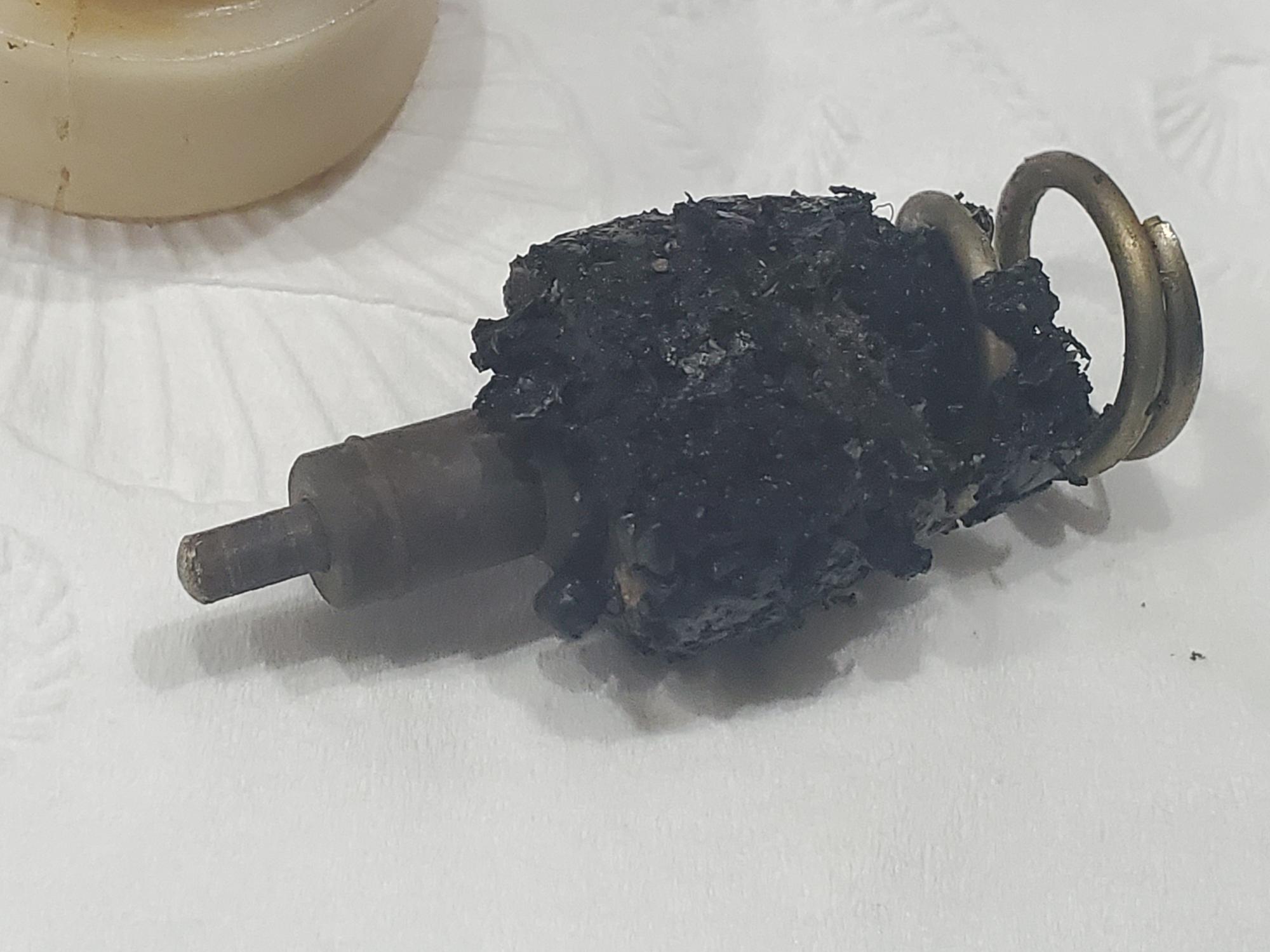

Answer to your first question is, I would not recommend it. Second answer would be yes test in hot water and check when it begins to close back up after you take it out. It must open fully by 145°. Many thermostats will start to open at about 120, but I like to see a temperature of about 130 to 135 to begin opening. This thermostat I tested yesterday began to open at about 120° and was fully open by 130°, so I replaced it with a Sierra made in USA. IMG_20210406_152626588_compress48.jpg
