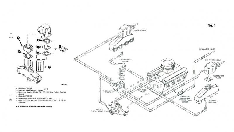

Ricardo, question for you. I’m in the process of replacing my exhaust elbows. It’s configured as follows... exhaust manifold, gasket, 3” riser, gasket then elbow. These gaskets come in two styles. p/n27-863724 has 2 out of the 4 water jackets sealed off and p/n27-863726 has all 4 of the water jackets open. Which gaskets should I be using between the manifold, riser and riser, elbow. ?
When I pulled my elbows I noticed the starboard side (restricted) elbow which had poor water return had gasket p/n27-863724 while the port side (unrestricted) elbow which had ample water return had gasket p/n27-863726. Coincidence? I think not.
Why the two two different styles?
Thanks in advance.

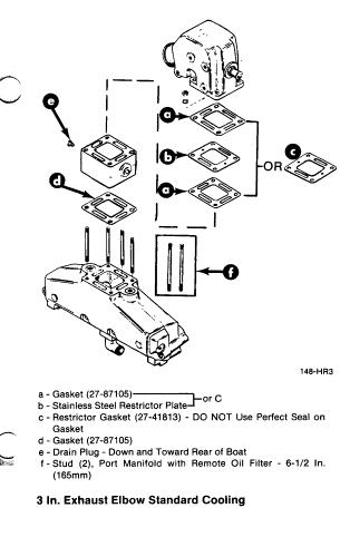

Based on the original Mercruiser manual (which Ricard the turd does NOT have)
See image I have attached for 3 inch spacer gasket type. Part numbers may be old as manual is also old.
In the image you either choose A-B-A or C
It shows gasket between manifold and spacer is open all 4 holes. Gasket between spacer and elbow is open two holes only and restricted the other two.
The reason for the restriction is you have cold water to the elbow from Tstat housing.
If the water flow was only through the exhaust manifold (from bottom up) then the gasket would be open on all 4 holes on both sides of spacer.
See the image that Jack posted. Then perhaps find an image that also shows the T-stat housing and the hose routing that are the same as what you have.
That was very likely and incorrectly put together by perhaps the previous owner.
Both sides should be gasket-ed the same.

805HD, look at these two images.
Is there a way that you could show us how your system is plumbed to the manifolds, spacers/risers and elbows (shown by Jack), and with the T-stat housing shown in the image to the right?
If you have a PC with MS Paint, you can manipulate the schematic to show what you have.... or print it and mark it up with a pencil.

thank you for the reply! I will go this route once my new elbows show up..
But let me ask you this, why not run the unrestricted gaskets? What would happen from running the unrestricted gaskets both sides of the riser. I only ask this out of curiosity cause in my mind more water flow would be better right?!
My understanding is to control hot water flow thru the manifold to the elbow.
Because you have the cold water inlet on the elbow, the restricted gasket restricts hot water flow from the exhaust manifold so the poppets work as this increases pressure thus allowing the colder water to elbows.
In later designs they did away with the poppets and went to a fixed orifice.
When there is no inlet to the elbows of colder water and all water flows up thru the manifold then there is a need for all four holes in the gasket to be open.
That is my understanding but the design engineers would know exactly why.........
