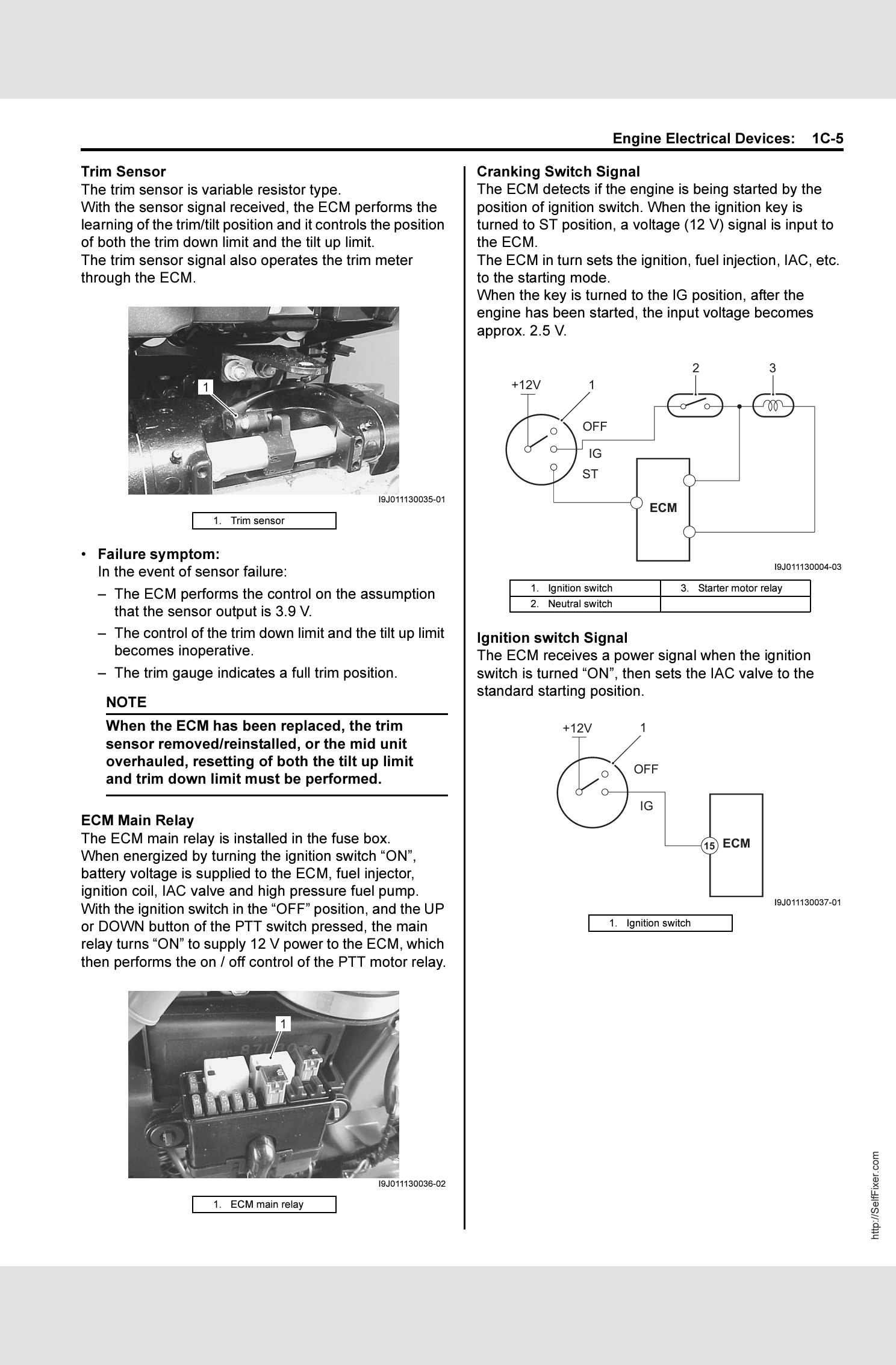

First off I have never had to set my trim and I have no experience with the gauges shown. I have read that the trim/tilt sensor can get bumped and screw up the limits you are trying to set. First off I’d compare both sensors alignment ensuring they are the same. I have read you have to tell the gauges via the menu which gauge is port and which is starboard, I think the reading I’ve done is referring to a single MFD not the two gauge setup that you have but it can’t hurt to check.
The above link is worth checking out, last I heard there is a problem with the forum and new members can’t join. Search for posts that “Moonlighter” has responded to, he is a wizard with Suzuki digital gauges. He is also a member on the Hull Truth boating forum, would be worth joining and posting your questions on the Suzuki Repower forum. He did mention he also joined a Bass Boat forum, which one I don’t know, maybe Google can find him?
Below is a picture from my 2009 DF90A service manual, not your engine but it should be similar.
Sorry I can’t be more help.
