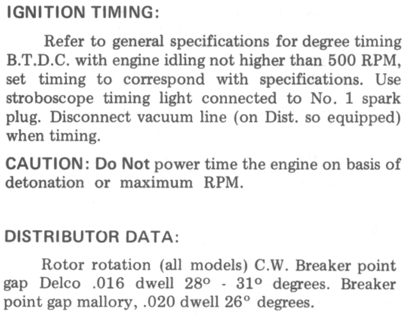

Rick, if the manual is to be believed, then the timing is set at 500 rpm and that's that.
That would be assuming (a dangerous word) that the mechanical advancing mechanism is working perfectly as per the OEM specs.
One rust compromised flyweight return spring (as in weak spring value), one broken flyweight return spring, one sticky flyweight, excessive shaft play, etc. ... and you'll have a progressive advance that is incorrect!
I'm not willing to make an assumption like that.

As usual you are assuming things that are not in evidence. This is what the people who built the engines say to do. Calling it BS is just not a responsible thing as it goes against the recommendations of the manufaturer.
Unless the engines have been fit with something other than what the factory put on there, you should stick to the manual.

I would be checking this out dynamically, of which apparently goes completely against the Crusader manual phrase that I drew the red outline around.
I know of NO true Marine mechanic who would set BASE advance only, and then walk away!
I don't think Crusader was saying, "Do not check the ignition system dynamic advance". When they say "power timing", my take is they are talking about the process some folks do where they adjust the timing only by ear. They rev up the engine a little and find the sweet spot where RPM is the highest and the engine is running the smoothest. Here's a guy advocating "power timing": https://forums.ihpartsamerica.com/threads/ignition-power-timing.2122/ (Just to be clear: I would never power time my engine.)
In the part Rick thinks is BS, Crusader was just saying, "Use a timing light and set the base timing to our spec".
As usual, there's the factory manual, then there's what Rick Says. Rick knows more about everything than anyone else on this forum, anyone who ever wrote a service manual, every engineer that ever worked for any marine manufacturer and anybody else you can name.
DJR, I would certainly hope not.
We should always look at what the progressive advance is doing from idle RPM to the full-in RPM.
Nor would I.
And DJR, you are correct! If Crusader is saying "DO NOT power time this engine" as though lifting the hatch and playing around with the distributor while under way and under a load......... I would completely agree with them.
Doing that is just plain stupid, and it's a recipe for engine damage.
