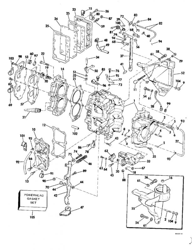

Parts can be bought right here on this site. Looks like you might be missing a bushing & the pin in the arm might be bent? See parts picture attached.
