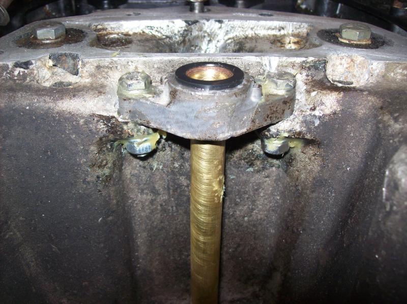

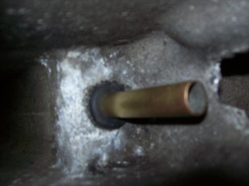

Installed the new thermostat with new gasket and seal. Cleaned up the water tube and re-installed with new water seal and lower grommet. Installed the powerhead onto the motor housing, it was freakin heavy. And yes, I remembered to install the shaft! Also hooked up the shift / throttle linkage before calling it a night at 1:30am.
Still have carbs, wiring to do.
Pictures are destroyed lower grommet, installed water tube with new seal, installed lower grommet, and destroyed water seal with shiny cleaned up brass water tube.

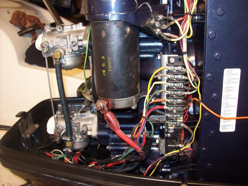

Carbs are back on. Adjusted float levels, new gaskets, linked. Printed the "link n sync" post to do when I get it on the water and running. Getting new fuel lines. Do I need some special "boat" fuel line or is fuel line from the auto store just fine?

Started replacing the fuel delivery lines. Got some nice Gates 1/4" fuel line. However I couldn't finish tonight because there is a difference in hose size at the quick connect fitting. Out of the boat the hose is 5/16". It goes into the squeeze bulb at 5/16". It leaves the squeeze bulb at 5/16". It then goes into a quick connect fittng at 5/16". On the other side of the quick connect it changes to 1/4", as are the rest of the motors fittings. That is all fine, I happen to have some 5/16" here at home. But the quick connect on the 1/4" side is pressed on to the old hose, can't use it, need a new quick connect with 5/16" in and 1/4" out. Does any of this sound familiar? Is this a normal set up?
And check out those carb covers, real beauts right? Need a couple replacements.
Also in the cover pic is the quick connect that was removed.

You might want to rebuild the starter.I see it still has the manufacture date on the side.
I did take the starter apart and cleaned it all up. Seems to be fine for now. You have a water separator?

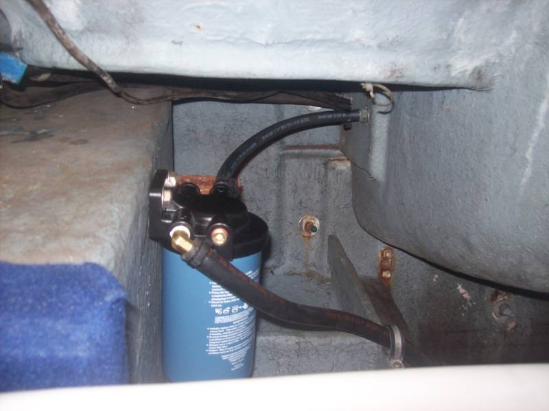

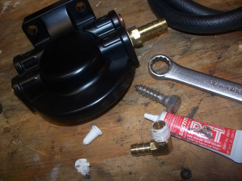

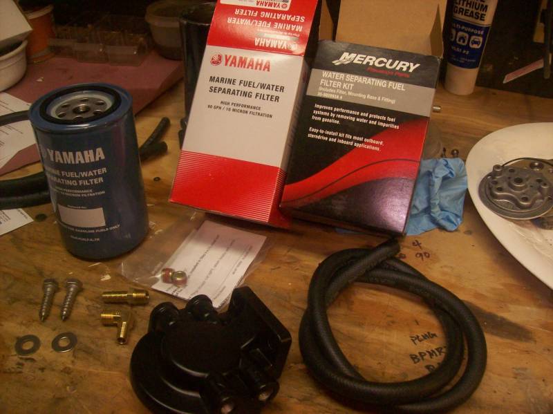

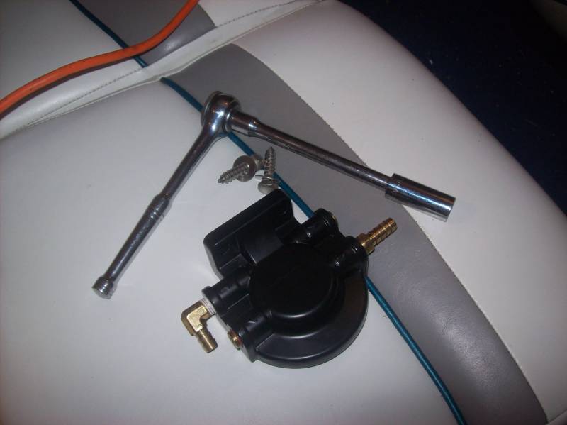

Installed the fuel separater and remaining fuel lines. All went in real easy, cost about $95 total with new clamps. All I need now is to get the valve body for the tilt figured out.
