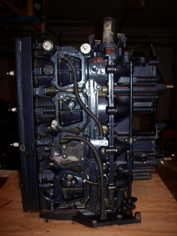

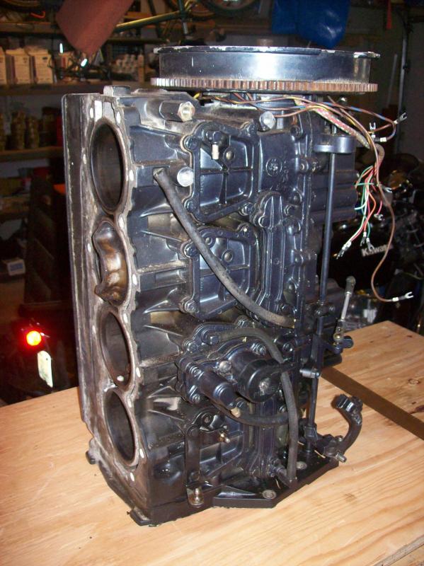

For now, my blown head is benched and ready to have all the goodies transferred to the new head. I have attached some pics of the blown block. Notice around cyl #4, the head gasket had a 1" hole in it at that spot also.
Any help along the way will be greatly appreciated! The Seloc manual I have is very vague in a lot of areas.....

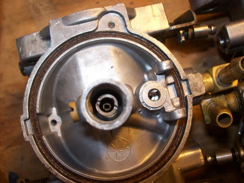

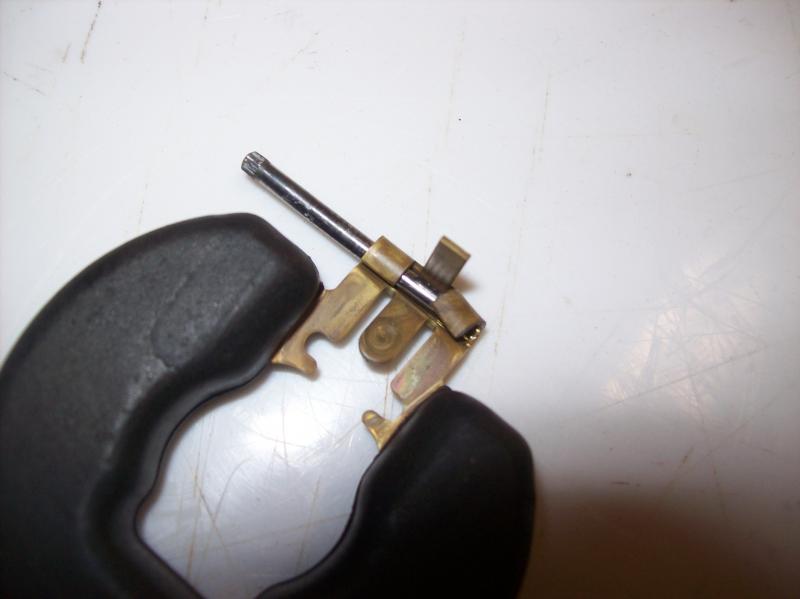

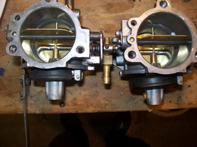

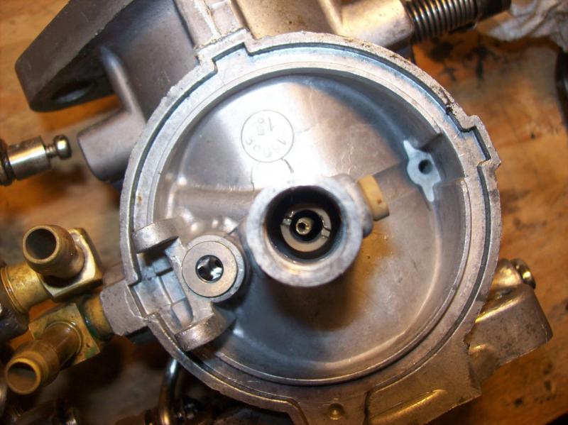

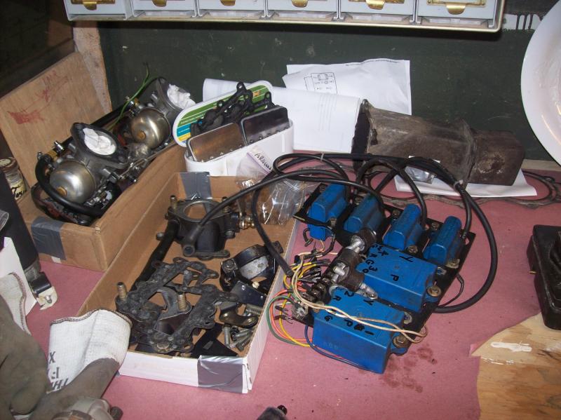

Took carbs apart tonight, found a few things that are questionable.
First, I found one of the float hinges bent. How the heck does that happen?? Bent it back straight, now moves loose and free.
Second and third....look at the idle tubes. Why are the visible ends chewed up/bent slightly? Does it matter?
Last, these are the set "closed inlet position" of the floats. Notice the one on the right. WAY out adjustment. I'll fix that.
Blew stuff out, everything looks peachy to me. Gonna get a couple new bowl gaskets and call it good. Anything I'm missing on these carbs? They seem pretty simple...

Make sure the float levels are right when you reassemble.You have a manual?I think most have the carb/float settings.
On iboats.com First post in the Force Forum.There is a post by FrankA called a linc and sinc.Do what he suggests when you re-assemble.
They are chewed up cause someone has taken them apart and screwed up the ends.As long as there is no blockage it should be ok.
Keep the gaskets in the carbs moist don't let them dry out.They will shrink and crack and dry.A bit of white lithium or silicone spray.Anything to keep them from drying out.J
I ordered new bowl gaskets, and bowl plug gaskets, and carb mounting gaskets. Is there more I should be concerned about drying out?
Yes, have an online Seloc manual. In the picture, the float height is correct on the left carb. The Link and Sync post is great info indeed!

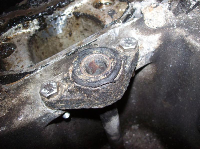

Got the boat into the garage today. Looking at the leg housing, I noticed the seal from the water inlet tube looked really bad. I'll take pix later. Ordered a seal and a grommet for the top of the tube. However, I don't know, do you have to remove the bracket on top and remove the inlet tube to replace the top seals? Or do the seals just go on top of the tube? Because I am afraid I will snap the 2 bolts that hold the bracket....I have them soaking in PB.
Get ready to drill and tap.Gotta remove the screws to replace the gromet.
if it tscares you too much.Some people just build it up with silicone(not recomended).J

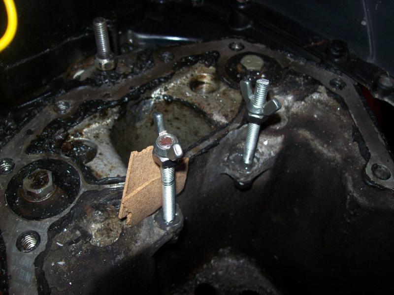

Jeez....you weren't kidding. Snapped both. Started drilling. Went thru many bits. One was broken bit got stuck and I had to alter drill path. Then a tap snapped off. It got pretty ugly on both holes. About half of the threads remained in each hole, just enough to hold the bolts in. So I cleaned it all up, placed some temp bolts in, (had to straighten one with a spacer), filled the gaps thoroughly with JB Weld. Hopefully I will be able to unscrew the temp bolts, then use new SS bolts that thread in and also put a nut on the bottom with a washer to "sandwich" the bracket on instead of relying on the home made threads alone.
Very frustrating.
I let the JB Weld dry for 24 hours. Broke the temporary bolts free and cleaned up the excess JB on the housing with a flat xacto blade. The new stainless bolts went right in and tightened up just fine. I will also add a washer and nut underneath to make the whole thing more secure. I think it will be fine.
