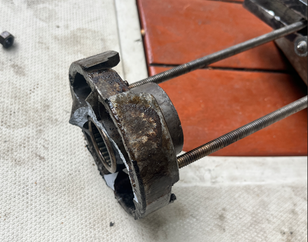

This is the bottom view that goes against the gears. Need to figure out how to break or remove material leaving the blue circled areas intact so I have something to pull on with the slide hammer.
What's so strange is the part you managed to extract is usually where they are stuck. Salt gets between the case and the carrier and seizes it in place. Mercs in the old days used to crack/spit the case in that area from salt expansion.
