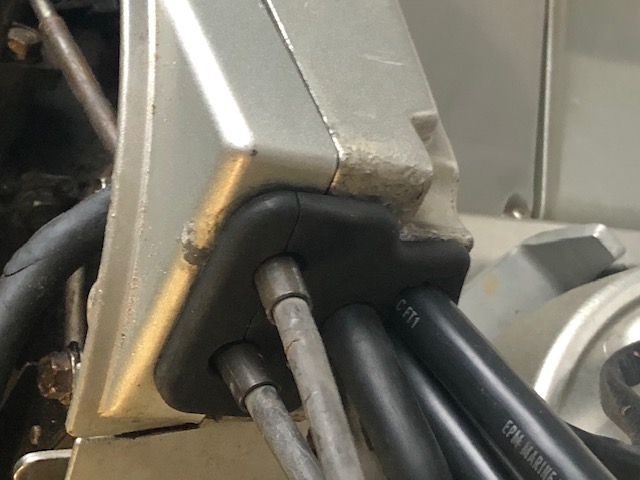

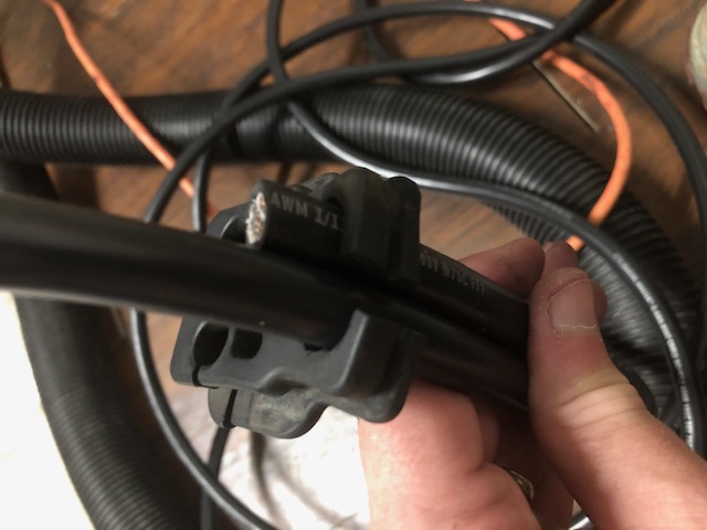

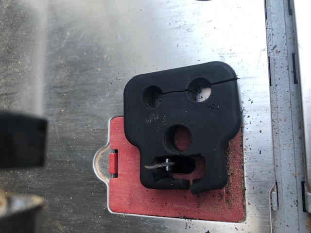

I've added a couple of pics. They are out of order, though. The last pic shows the too-tight grommet. The middle shows the widening of the grommet using a table skill saw (much easier than the mat knife). And in the end the cables fit. Thanks again!
PS. If anyone notes the crack in my throttle cable and has any helpful comments, please chime in. Cheers! MD

Well, I call that tool a jig-saw and that particular operation looks hazardous to the fingers.
But you pulled it off nicely and would have probably mentioned any limb loss so....
.... GOOD JOB ;>)
I think I see a bad spot in the cable "collar" piece. Is that the split you're referring to?
If so, and the cable housing doesn't move in and out of that piece it might hold up for some time.
As long as your throttle still works properly I would just keep an eye on it for now and fill that gap with a dab of flexible gasket maker to keep water out.
GOODONYA for sharing!
I'd plan on replacing those cracked cables at the first sign of any stiffness in your controls. Those cracks are due to the amount of time they've spent out in the sun and are a pretty good indicator of impending doom....
