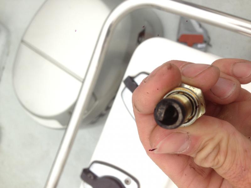

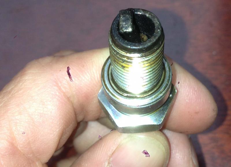

I checked the spark plugs and all of them were pretty junked. One in particular may even be in effective. Thinking this may be the culprit...

Yep - that's pretty junky. But you need to determine why they have carboned up so badly. Could be just worn out plugs, but check your thermostat(s). That excess carbon could be caused by running the engine too cold, caused by a thermostat that is stuck open. Or, it could still be maladjusted carbs.

Do all your plugs look the same? Could be the Sea Foam treatment.
Make sure your plugs are NGK DR7EA.

If changing the plugs does not help, run the engine on a hose at idle and pull the spark plug wires off of the spark plugs one at a time (with an insulated pliers). The engine should run worse when you pull each one off. You just have to do it for a couple of seconds to see if there is any effect. Then, put the plug wire cap just over the plug so you can hear the ticking of the spark.
If you hear spark ....you have spark. If the engine drops in rpm, that cylinder is firing. If there is no drop in rpm, then you found the cylinder that has an issue.
Generally, if the motor ran ok when you put it away....and it doesn't run well in the Spring, then it is normally....what chawkman said, fuel issues, critter issues, or something affected by moisture. If it were a fuel injected engine, it might also be a battery issue.

I actually really think its was this one particular cylinder (4th - closest to the bottom). I just question how the electrode could be bent and what would cause that. These pics illustrate the problem a bit better and worry me more. I am going to take a run in a bit with new plugs and see what happens...
thx again guys
