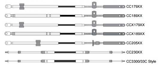

My father in law has an older pontoon boat that needs the shift cable replaced. I went off info he had given me and ordered a replacement cable and of course it ended up being the wrong cable. I have since did some research of my own and found the OB is a 1985 Mariner 40hp, model 40EL 6E9L 421562. The controller is a Mercury commander. The replacement cable I bought fit the engine fine but the plastic guide that goes into the controller is too long. The replacement cable I purchased was a Teleflex 3300. I do not have the original cable as it was thrown away by my father in law. Can someone point me in the right direction to get the correct replacement cable.
