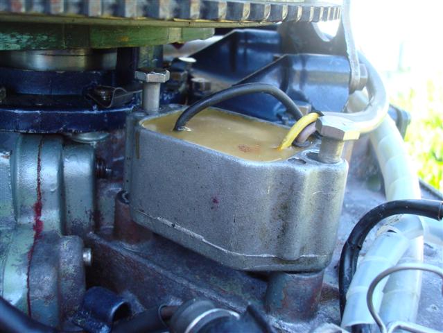

On a side note, the purple wire only goes to one thing on the motor (from the remote control cable anyway). It is not on any print I have so can you look at the picture and tell me what it is and what it does? On the print the purple wire goes to an empty terminal on the strip where the charge wires are.

That item appears (to me) to be a voltage regulator.
