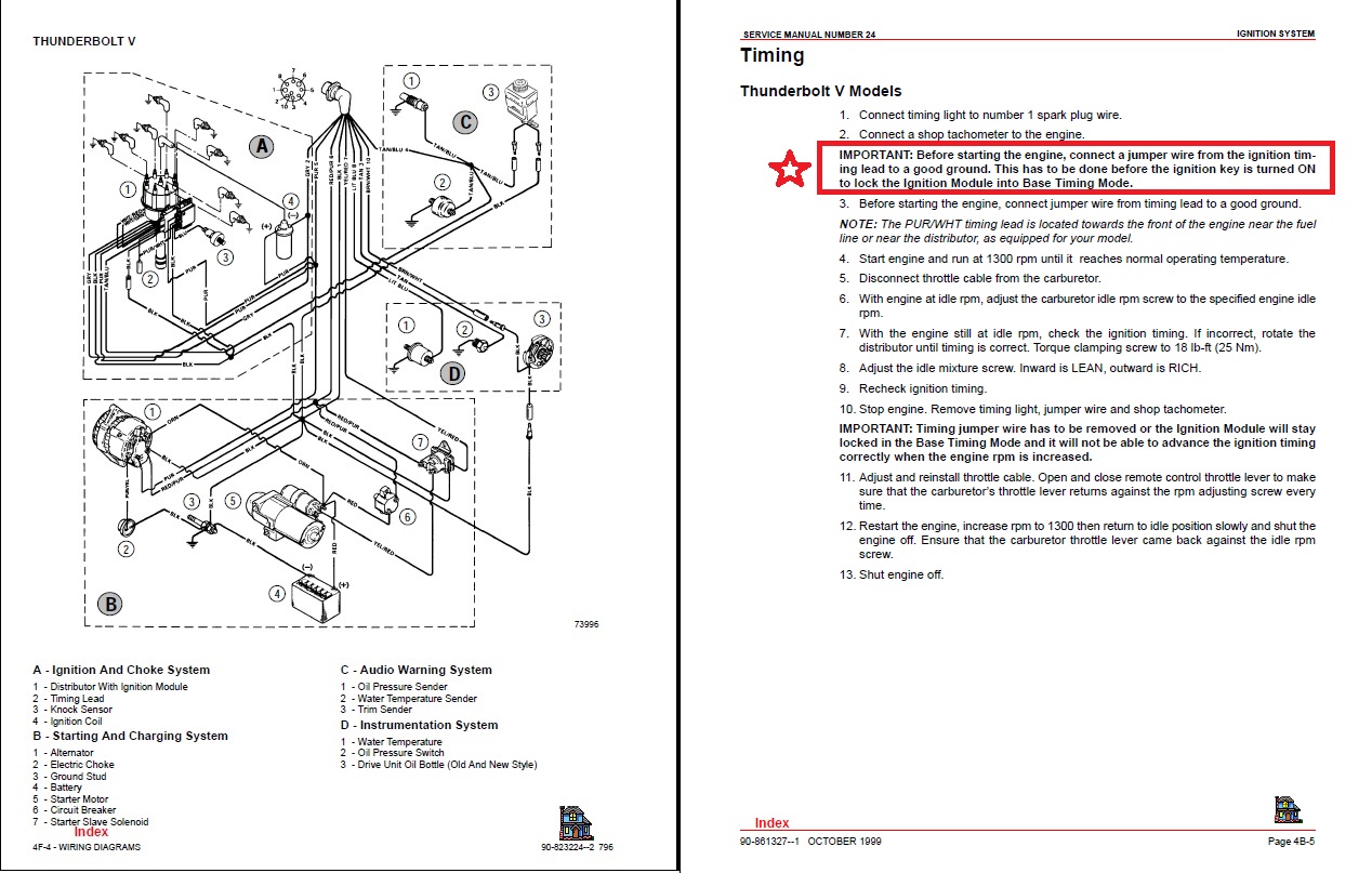

Tbolt V needs to be put in base mode to set the timing. There is a bullet connector that is capped in the harness by the shift interrupt. You ground this before starting the engine. Can easily set it to 10 deg BTDC or whatever the engine calls for. Remove the ground and restart the engine it is out of base mode. Great ignition system with a very hot spark, only bump wrap is if u need to replace ignition module it’s like $500-600. I bought a spare on eBay for $150

google thunderbolt V ignition systemor post some pics what you’ve got, but if it is the OEM ignition that came with your 220 hp 5.0it will be the thunderbolt V with the ignition module on the exhaust elbow.
if your mechanic didn’t set it in Base mode and rotated the distributor to 10 degrees you will have very retarded timing as the module will be pushing some advance even at idle.
link for setting timing it’s easy to do with a basic timing light. http://download.brunswick-marine.co...n/mercruiser/gasoline/861328-1/8613281_4b.pdf

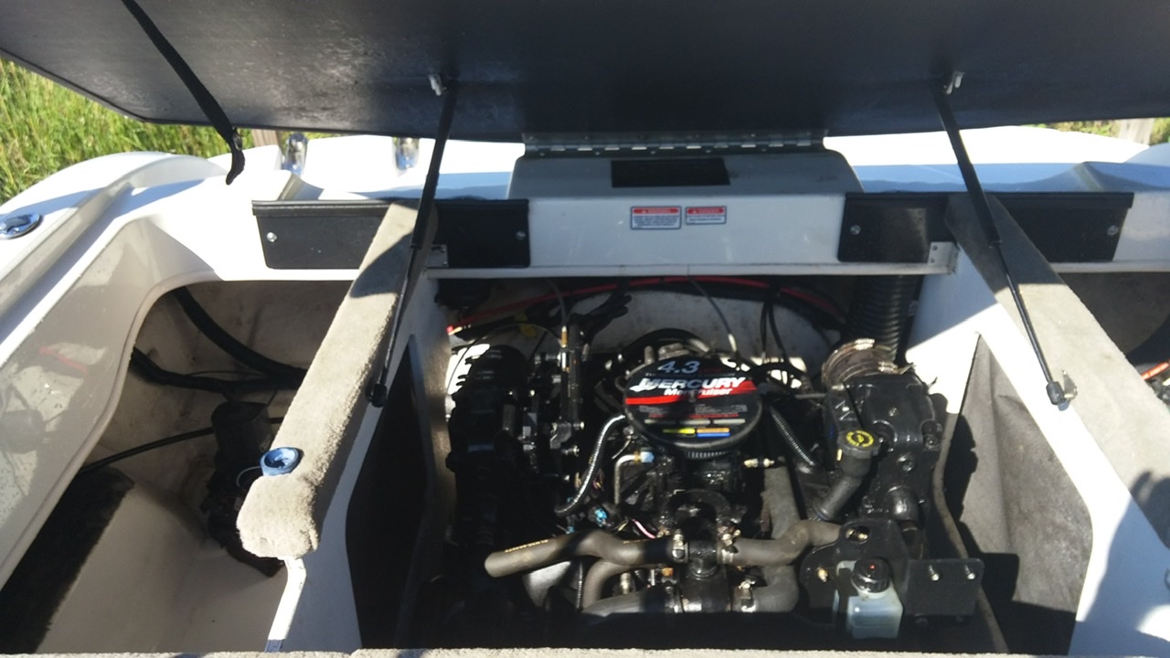

So, a little more information and update. Went out to the boat today but it was late and getting dark so I couldnt get decent pictures. I am pretty sure there is something wrong or missing. I found the purple and white wire coming out of the DENSO module mounted to the exhaust elbow. but it goes from the elbow into a loom, and I keep reading in the manuals theres supposed to be some type of lead or other end to use the jumper cable to ground? I connected a probe to that wire at the module and grounding does nothing to the timing. We double checked with the timing light and then ungrounded and rechecked current timing. At idle the motor was sitting at 10 BTDC, and it didn't jump around at all which I have read should be indicative of a thunderbolt 5 igniton, that it should be kind of erratic when not grounded as it adjusts. we revved up to 2400 RPM and it is still sitting dead on 10 BTDC so it isn't advancing at all.

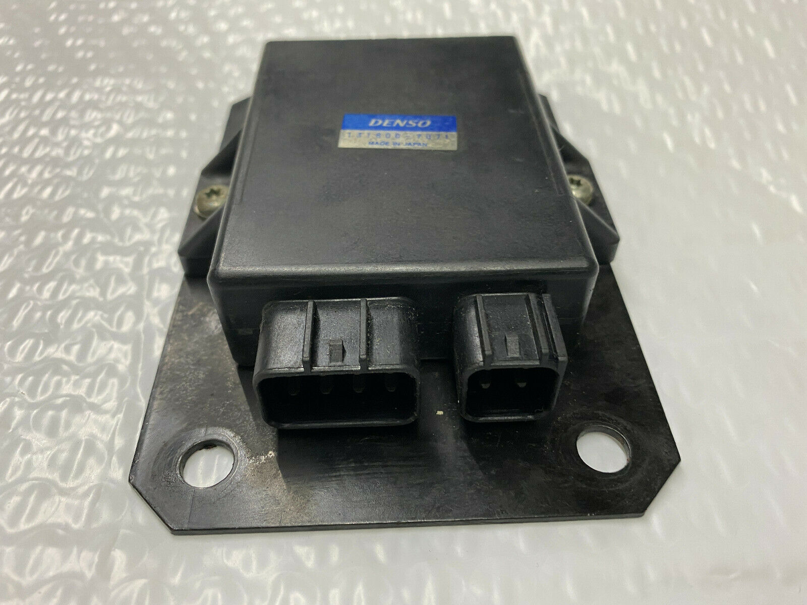

My understanding after researching is that this module requires input from a knock sensor on that pur/white wire to adjust? but I get no signal on that wire at all while motor is running.
The Ignition Module I have is this one, pic stolen from an ebay post, and there is no secondary module attached with it like I've seen in some other photos.

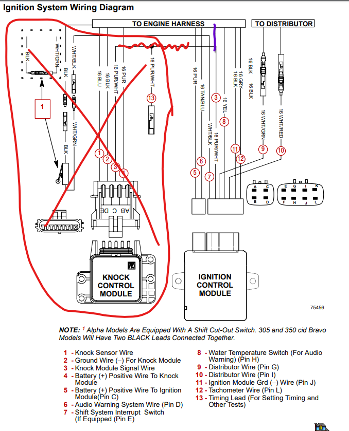

I found this diagram of the TBV ignition system and basically everything in red I don't see though maybe its just somewhere Im not looking? the purple and white wire just goes into the engine harness loom

note that in that diagram, c and d are mislabeled. That is, box c is identified in chart d and vice versa.
say what?
Ok got it.............But this may add confusion as C and D have NOTHING TO DO WITH ISSUE
As outlined in post 7 - the bullet connector is by the shift interrupt which is mounted to the other elbow opposite where the denso labeled ignition module will be a wire with a small plastic plug in it coming out of the harness jumper this to ground before starting engine. This is 13 in your diagram but will be located in harness on other side of engine by shift interrupt. That drawing is a tad misleading
knock sensor is something totally different and has nothing to do with setting base timing, and your like most 5.0 carved motors didn’t have one
O2batsea is simply adding clarification.
Do not assume that others will become confused.

Which drawing? The one from the Mercruiser Manual? Or the one he posted that he acquired from the internet?
On the OPs drawing where he crossed out in red. On my harness this is physically located right next to the connection for shift interrupt and lays on top of intake. I think OP was looking for it between the module and the distributor
If that module is mounted on the elbow then someone got creative because that module is neither TB IV or TB V This is TB V
Post some pics of what YOU have on the motor
my TB V was mounted on the elbow from the factory just behind oil fill second photo uploaded with better resolution ...
