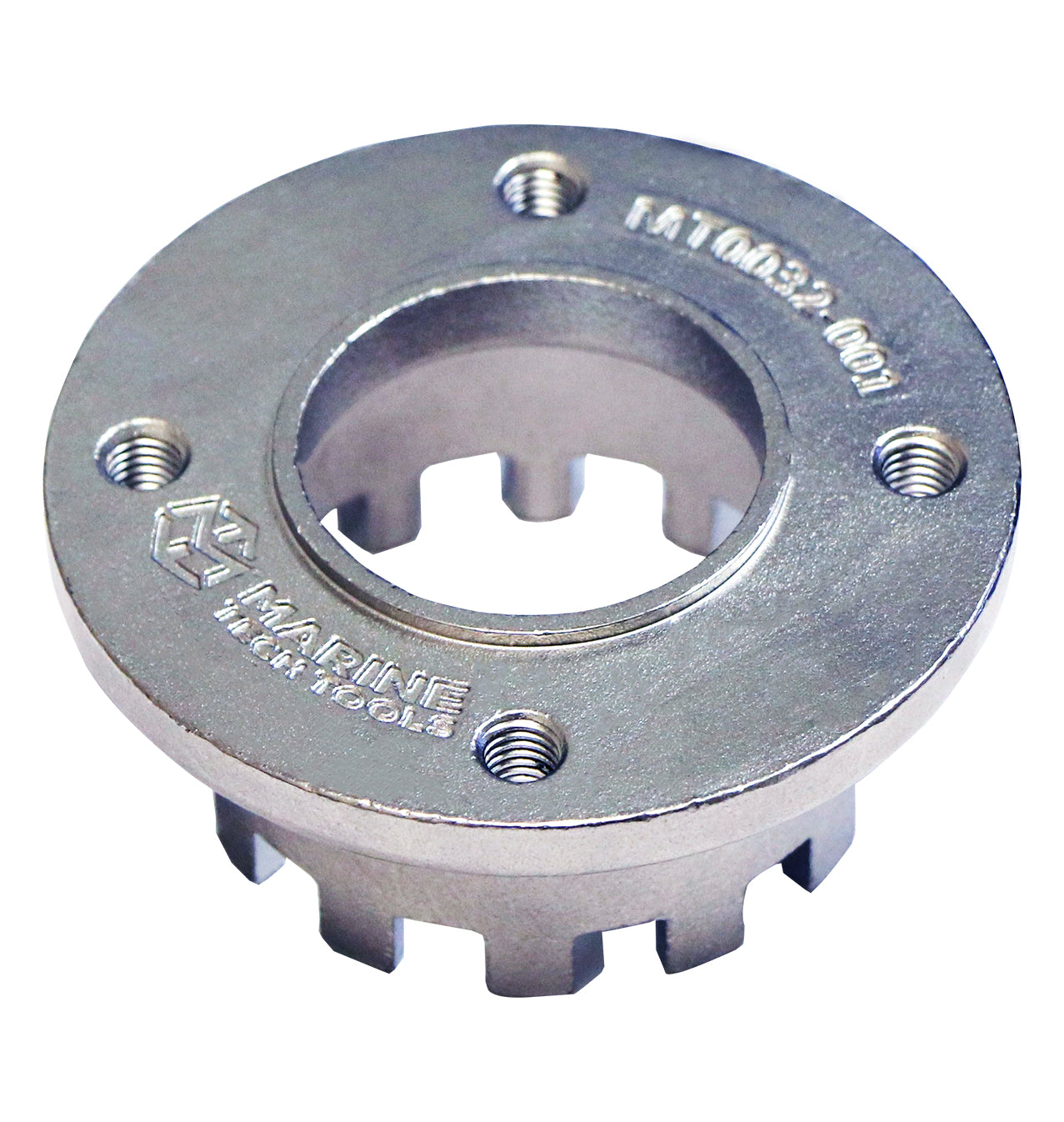

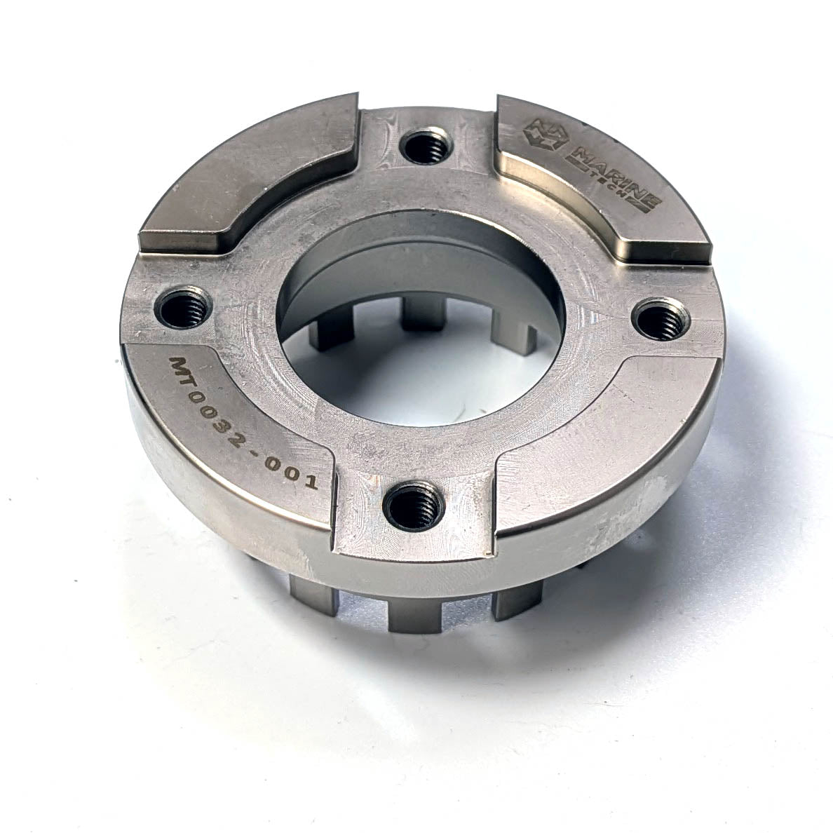

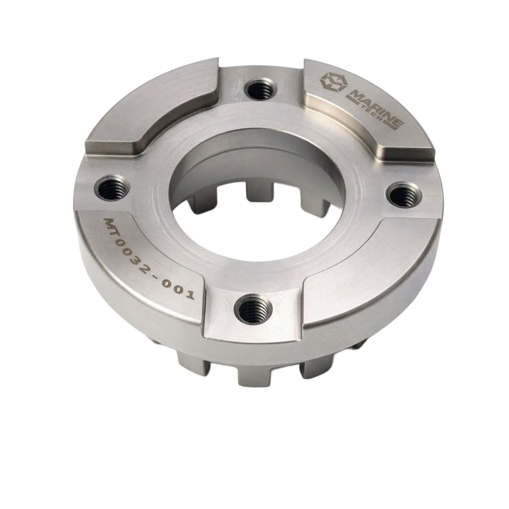

So it looks like I have to buy a 12 tooth wrench attachment to remove the gear case end nut, #7 above. The wrench attachment appears to be this https://a.co/d/6dHgMrK

Yup, I ordered one of those plus the attachment piece that fits over your prop shaft. $120 is a lot for something I'll only use once or twice, but I'm sure someone will buy it when I'm done.
