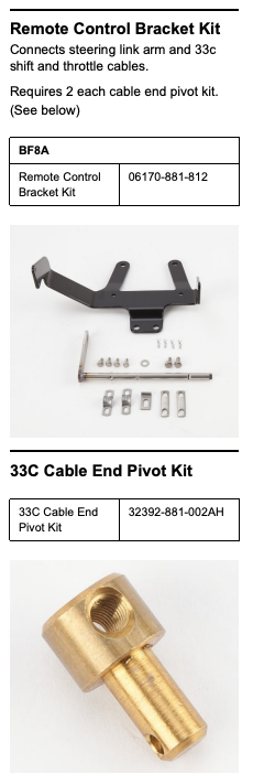

Here's a link to boats.net It's a good place to reference, price and order parts for Hondas
https://www.boats.net/catalog/honda/outboard/8hp/bf8ak0-la-vin-bzbc-2100001-to-bzbc-9999999
Good luck
P.S. note the remote control kit and the related parts you might need at the bottom of that page. Very pricey in my opinion.

I really do wish I could be of more help to you but as I said, I have never done this. I have a suspicion though that this "project" will likely throw a couple of curves at you and the parts that you have listed may not end up being everything you need.
For example, you list (×2?) for the shift cable so I'm assuming you're thinking of using one as a throttle control? That may or may not work. I don't know.
As far as what controller to use, that's a great question but I can't help there either.

The conversion kit is 70$ as a bundle, but it is overpriced (more than 200$) if bought part by part
You are right, controller must be as compact and sturdy as possible.
I have a few ideas and will ask Honda Marine for compatibility w/ the kit/cables - if I have a positive answer, I will look for a used one.
