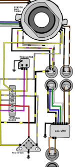

Remove yellow wires from terminal block.-----Put ohmmeter on the yellow to yellow on stator.----What is the reading ?----Put ohmmeter on one yellow and ground.----What is the reading ?
As I look at the wire diagram,( attached) I see one yellow wire from the stator and the other is a gray and yellow. Is those the ones you are talking about?

I don't know that I'm doing it correctly. I'm testing in the same manner as I did the rectifier. In any case, when connecting yellow wire from stator to ground - I get no reading. Tested same yellow stator wire against both yellows from rectifier - no readings. Again, not sure that is what you instructed.

I know you said to ignore the gray/yellow wire but it is the only other wire that comes out of the stator that connects to the terminal block. I tested between it and the only yellow wire coming from the stator. I get a quick reading but abruptly goes to 00.0.....does that mean anything? no readings when test ground.
???---One meter probe on yellow------Other probe on other yellow.-----What is the reading and are you using a digital meter ?
Yes....using digital meter, but there is only 1 solid colored yellow wire coming from the stator to the terminal block.

Did you read post #5 ??-----I likely have more than 1 stator to fit your motor !---Years of experience.----Run to a shop and have this simple test done.
