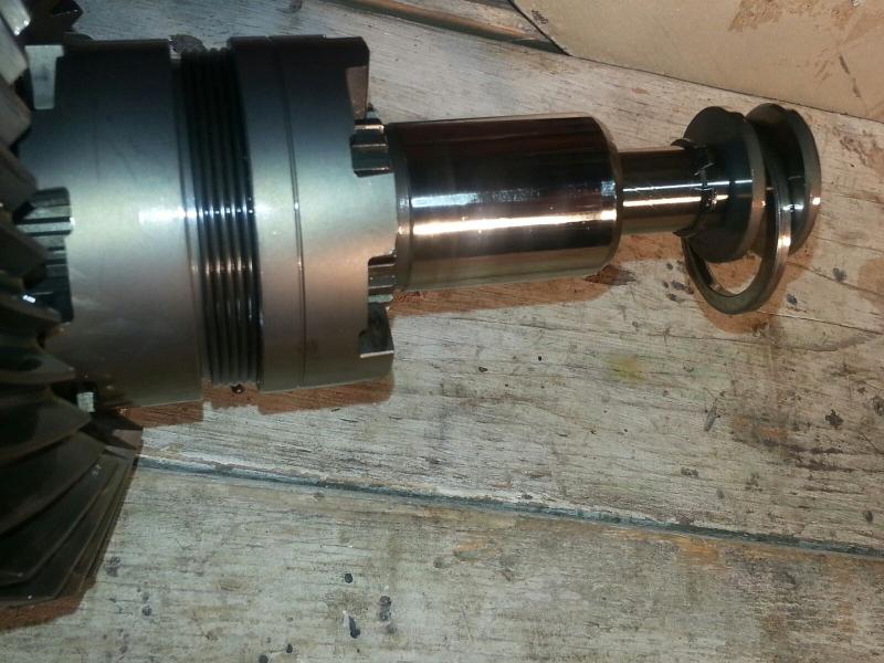

Ok, I removed the shift shaft like Hondadude said and everything slid out in tact... (I think)..lol..I just just use the housing from this one and use all the gearing and shafts from my original lower unit. Apparently the prop shaft is slightly bent on the donor and the shaft length is 30" and I need 25". So here are a few pics of the donor take apart job.

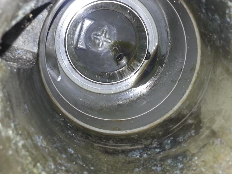

I made a tool to remove lock nut for drive shaft. I'm guessing this was one of Honda's "special" tools.

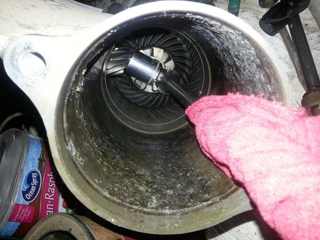

Next I had to remove pinion nut and used pipe wrench on shaft carefully trying not to mar the exhaust housing.
I was able to pull drive shaft out, while holding pinion gear in place. Then I hear loose metal falling inside. It was the needle bearings coming out of place. The whole unit looks like its in really good shape, other than having a bent prop shaft.
