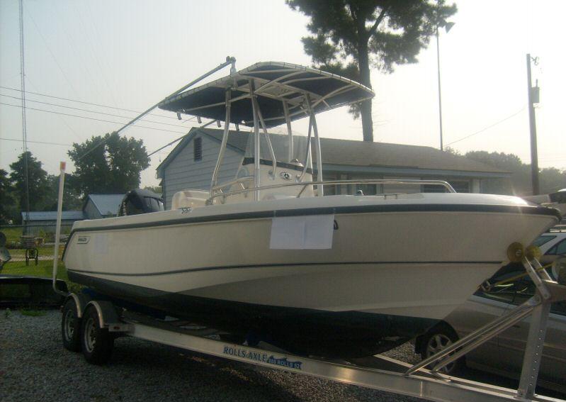

It's not particularly a deep v as you can hopefully see from this pic - it's a 8.5ft beam. We don't really have access to props to try unfortunately so we need to get this right if we're buying. I'm thinking a 17" pitch might be better than a 19.

Can't tell for sure, but that looks like a modified V.
