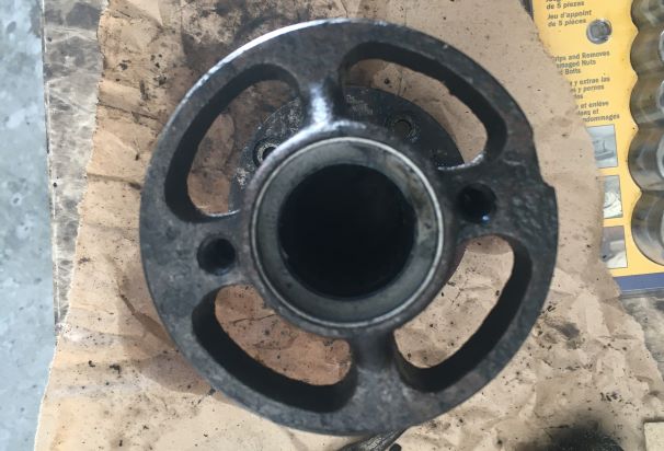

IMG-1208250.jpg heres the bearing carrier minus the outward facing seal.

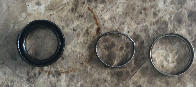

IMG-1212.jpg here is the rubber seal, spring, and an inner ring I pulled off the carrier.

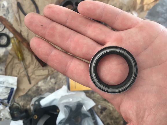

IMG-1210 (1).JPG And here is the new piece. Part number 330137 on the 1977 70 hp 20" transom 70773S
my man! my plan of action was to wedge a small screw driver in between where (I think) the two seals meet. no luck so far though.
I've got one that will hopefully work. The seal is already starting to bend so it shouldn't be too difficult to wedge in there.
