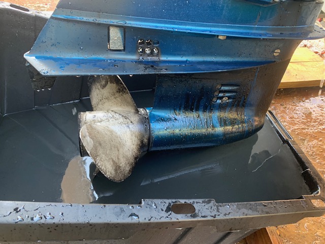

I’d like too but I was concerned about the oil getting in the water. Im guessing the oil droplets are unburned oil in the fuel. I rebuild all the carbs with OEM Evinrude kits and made sure they were super clean. All jets removed and checked and clean. I need to add that I found #1 cylinder not firing with the spark tester and discovered a connection on coil was loose. I sure thought I’d found the problem! It started and ran much smoother but still the smoke and oil in the water.
Here is a good pic of the oil droplets in the water. When you tilt to pull the tote out all the oil sticks to gearcase.

There is not nearly enuff water in your test bucket.-----Test compression with a better gauge.

R1 you’re absolutely right! Let me explain the use of the tote. I started using it sometime back to verify the water flow out of the side grills in the gear case. Tell tale always has good flow!

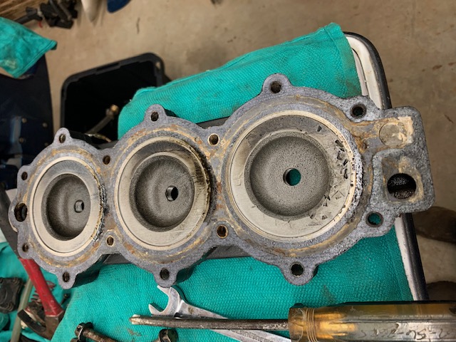

R1, wanted to add these pics for you to checkout these are back when I checked the thermostat and for scaling in the block. Notice in the head on #3 the damage (what I thought was old damage from days gone by). Maybe it’s not old damage at all.

That damage resulted from broken piston rings.-----Likely his motor was apart before.----Any other numbers on those pistons ?------And I do not like the looks of the #2 piston.-----Looks like it is running hot.

R1, let me skip back to why I used the tote. It was after I replaced the impeller and changed the oil in the gear case. When I put the gear case back on and put the muffs on it. I started it up and water was shooting everywhere so I took it back down to check my work and couldn’t find anything wrong with what I did so back together again only to get the same results water shooting out the seam between the midsection and gear case not out the side grills like the manual shows. So I pulled the gear case off again and decided to check the water flow to see what was going on. I went as deep as to pull the head so I could see if the block was scaled up also checked the thermostat. All that was fine with no scale in the block and a new thermostat. So bottom line after some rigged up some tubing to simulate the water flow I discovered the flow was fine but the seam between the midsection and gearcase wasn’t sealing very well so I used some gasket sealer around edges to take care of that. Once back together and in the tote I fired up it was fine flow was like the manual shows. I needed to see the discharge out the side grills to make sure it was right and the tote was the perfect level. Anyways thats why the tote. But you absolutely right water needs to be a over the impeller.

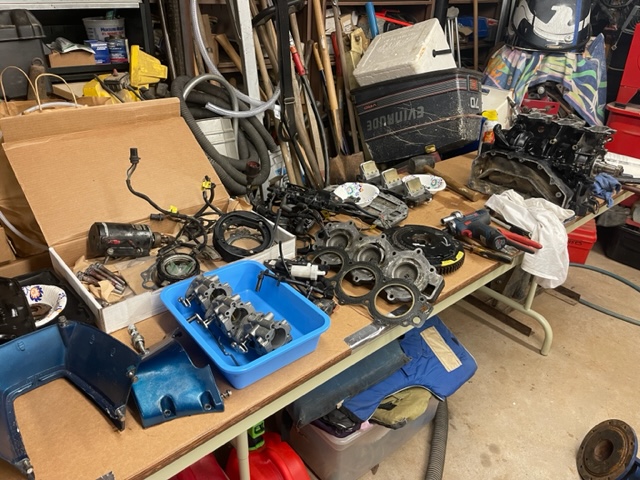

R1 and BigT, Tear down underway! I hope to have the block all the way down tomorrow and some pics to post on what I find! So far knock on wood no broke bolts...
