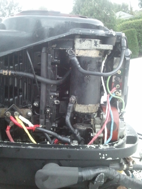

this is a picture of the engine. i cant find the black/yellow wire boat engine.jpg

There will not be a black/yellow wire on this outboard.It looks to be '71/'72.Is there a number on the starter bracket?
As that's the starter side,I'll assume there is a distributor on the other side,going by the switch-box.The square box with the colour coded terminals in front of the starter.That is probably fried.The main reason this gets fried is someone has connected the battery assways,or disconnected the battery while the engine is running.

You need to submit a photo of the other side, where the distributor is. IF it's the usual, battery powered ignition model, then there are lots of good, used switch boxes for those on eBay. (You MIGHT have the rare Lightning Energizer distributor, however. Need to see a photo to be sure.)
When we figure out which ignition you have, I can give you the correct part number to use while you're "shopping".
