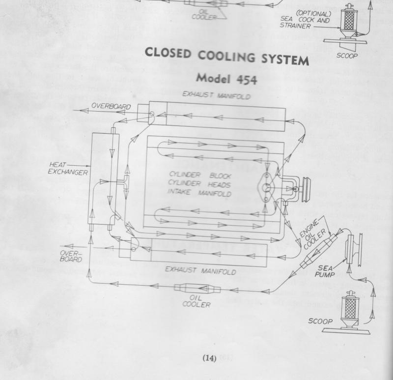

This is out of my engine's manual. It looks like Full System to me.
If your manifolds are fresh water cooled, they are most likely not the problem. Chief suspect for water in oil should be your exhaust risers and elbows, which are raw water cooled.
