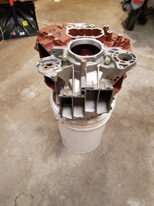

I'm looking for 4 new standard pistons and ring sets for 1966 Evinrude 80hp Starflite.
Part numbers for pistons: 380569 or 385282
Part numbers for rings: 380110 or 382825
These are the part numbers given under the parts section for this engine on marienengine.com. Maybe some of you know other part numbers that would cross reference.
I know some are available from Marineengine.com but remember several on this forum saying they had parts available for sale too.
What is the reason you are changing the pistons? I would consider boring .020 over so your sure the cylinders are nice and round and the piston to cyl clearance is within spec.
Not really anything noticeable maybe a few ponies. Are the cylinders nice and clean and have a good crosshatch. Being NOS the cylinders may need a light hone to clean any defects before you install new pistons. The machine shop would be able to tell you if you need standard or oversize pistons and rings?
Had it checked out by a machinist. All 4 in specs for standard piston. It needs crosshatched. Any suggestions on what type of hone to use and grit. I've seen this flexible hone. Any suggestions are appreciated.

I appreciate all your information. The NOS power head cylinder walls has a small amount of surface rust, no pitting. I'd like to clean them up and obtain a good crosshatch pattern. The standard bore is 3 3/8". What size, grit, and abrasive flex hone would you suggest?
Post # 4 clearly states a new powerhead.-------I wondered if you were going to take it apart first , that is all for now.
Nice just take your time you got alot of work ahead. keep all the metal parts lightly oiled it dont take long for dry parts to develop rust.
