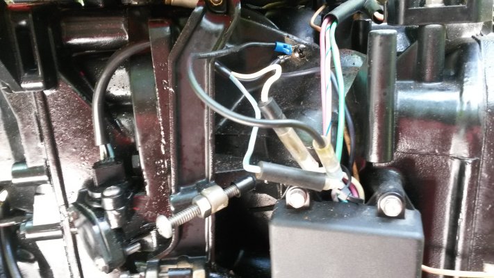

Okay, I pulled all plugs this morning and still only firing no.3. I am still not sure of how to test the stator. I have 2 yellow and 2 yellow with black tracer wires coming from the stator to a terminal block on back of engine. This block also has some red wires on another post. There is also a device on the port side of the engine. This device is inserted into the engine block and looks to me like some kind of proximity switch. It has three wires, one of which is grounded. The other two, a blue and a white, go into a black box mounted on the port side also. This box has a purple, a tan/blue, a green and a black. I don't see these on any of the diagrams I have been able to find.
Help please. Do I maybe have a aftermarket stator with different color wiring? Is there any testing I can do with a standard multi-meter?
Here is a picture of the other device that I can't find in a wiring diagram. Any ideas?
Okay, I figured out what the other device and box are. They are the oil injection pump sensor and control unit. The oil injector has been removed so I am going to disconnect the control unit and see if that helps with the firing problem.
