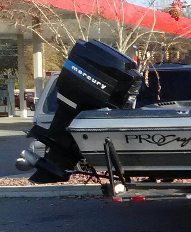

I have an older Mercury 150 that will trim up and down fine when on the trailer or when at idle speed. However, when the boat comes out of the hole, it will not trim up. The fluid resivour is full, but looks a bit "Milky" which makes me think it may be a bad seal on the hyd. ram or something. I just bought this boat so any suggestions would be greatly appriecated. Thanks in advance.

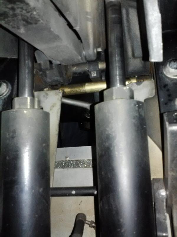

Trim Rams.jpg... O.K. I was wrong. There are only 2 rams. Neither appear to be leaking. Please see the pics and let me know if you can help in any way. I'm assuming this is not a 92 because of the 2 rams. I tried to look it up last night by serial lnumber to find out year and\or model, but had no luck. Outboard.jpg
If the manual release is closed and it leaks down ,then there may be an internal seal on a piston leaking.----You would not see such a leak.------Check the manual release first.
That the old style 2 ram with trim pump in boat, either rams seals, ram hoses or high pressure check valve internal problem, you also must use a 30W oil in this system..

Post a few close-up pictures of the pump.------Perhaps there is a manual release device that can be pointed out using pictures.
