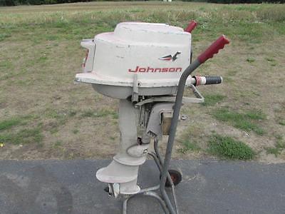

I have a Johnson 5.5 CD-18, I believe it's a 1961. I tried 50:1 fuel mixture and I have oil spitting out of the pee hole and smokes a lot. I am using a trash can with water in it for testing and tried tuning the carburetor and can't get it to run right. I believe the mix is supposed to be 24:1, but wouldn't that make it worse or no? Also the water is spitting out and not a stream.

If you just bought this motor you need to install a new impeller.------Powerhead must be lifted off to disconnect the shift rod to do this.-----Yes this motor has needle bearings on the con rod like models that run at 50:1.-----Post the compression test values here.----Original head gaskets were weak.----Replacements are improved with a metal ring.------If coils are original they will be cracked.-----Remove recoil .---Remove inspection cover and inspect coils through hole in flywheel.

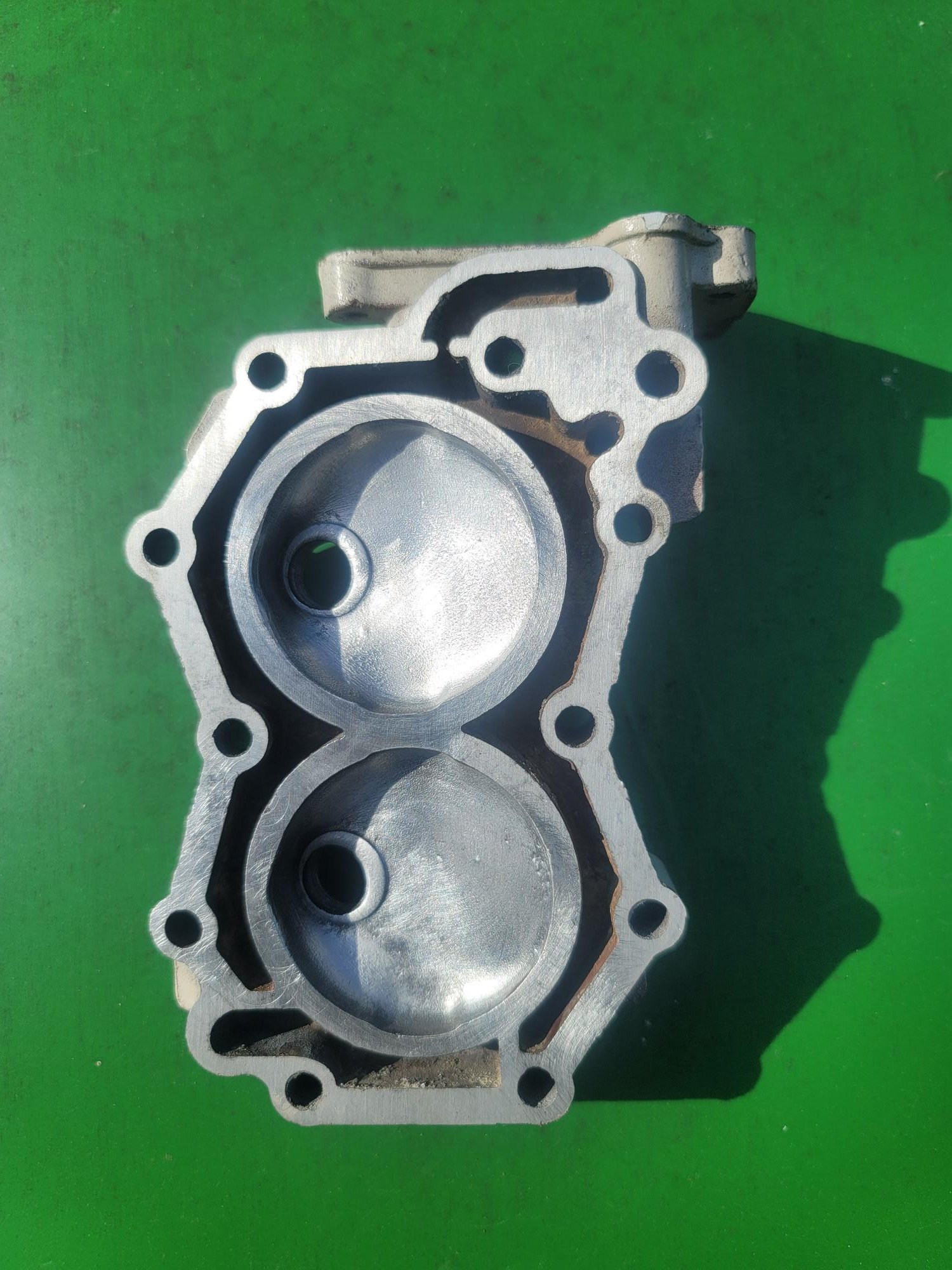

If it has the original head gasket , I would remove cylinder head.-----The head will be warped and gasket may be leaking between cylinders.----Resurface the head and install a new gasket.
I cleaned it up a bit and sanded the head. What is the compression supposed to be?
