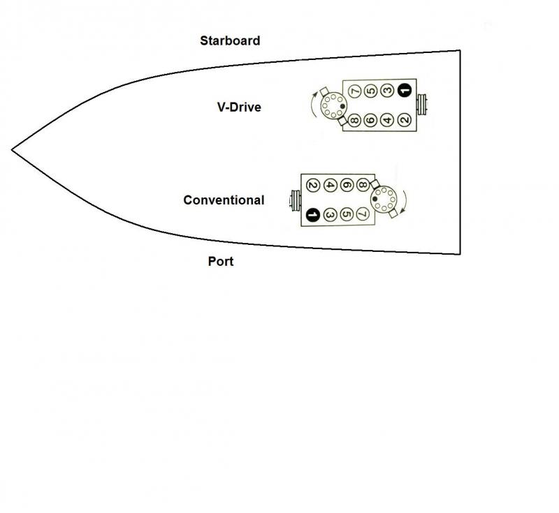

Mictat2214, in all fairness, let's re-examine the thread string here. It may help you see how you were in error.
You did say; 1st plug, port side forward!
JJ said; "Not if you have V-drives." (he's referring to your verbiage of "port side")
JJ said; "When looking at the timing marks on the flywheel, it's the furthest cylinder on the left side bank. All the time, every time."
Then you came back with; "Forward meaning the FRONT
of the engine" and you have now omitted the verbiage "Port Side".
(you can't have it both ways)
Then JJ came back and corrected you; "You said PORT side forward."
You then come back with; "Front of the engine is the end opposite the flywheel"
That appears to be a filibuster in that it does not address what JJ has been suggesting to you.
JJ then says; "To repeat myself again, you said PORT side. Do you know where port side is?"
At this point I went for popcorn, and secretly had a Margarita! :D
When I came back, I made this image to show how #1 cylinder may swap sides (port/stbd) when engine orientation changes.
It should be fairly clear as to what occurs.
In post #117 , I see two things:
1.... perhaps another filibuster skirting the actual issue.
2.... an opportunity to admit your error to JJ, but was passed up.
post #118, JJ can't help but see the filibuster. I can only assume that the rest of us do as well!
Mictat2214, this all boils down to your usage of the words "port side" in your first statement. Had you omitted "port side"........., you'd have been correct. But you did include "port side", and I believe that why JJ addressed it............. I may have also, had he not.
Words have meanings! :D

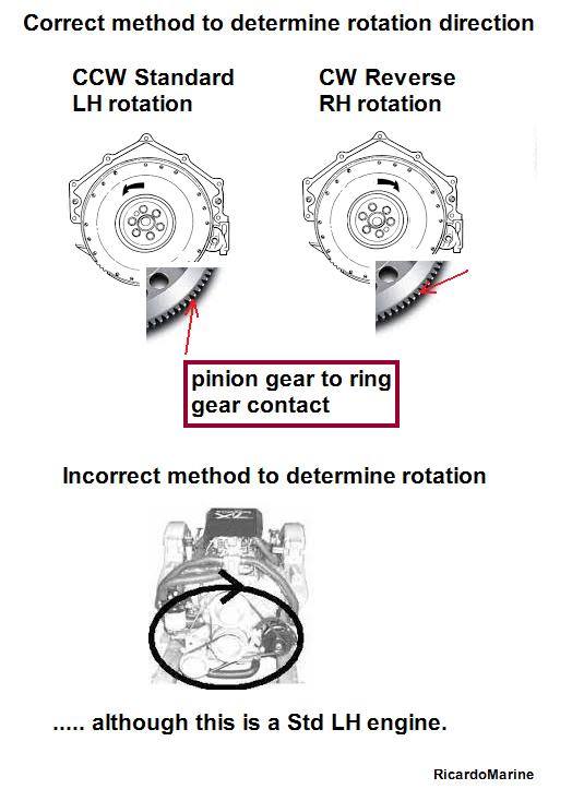

how do I know if 318 is reverse rotation or not?
Its in my 1979 silverton 26 flybridge single engine with a v drive.
I just blew the motor and am thinking about buying a remanufactured.
I'm not sure if its a reverse rotation or not. how do I know which one to order?
This is how my boat firing order is set up now, I need to replace the engine,
I'm just trying to find out if my engine is a standard rotation or a reverse rotation.
Also, when I crank the engine the distributor rotor turns in a clockwise position.
Thank you for your time,
Eric
So for real,
I'm just a shadetree mechanic and this forum has just got me very confused...
would mine be the one circled in green or the one circled in red ?
Eric, you certainly aren't in any trouble here..... but you have you resurrected a thread that was started over 4 years ago, and one that was started regarding the #1 cylinder position/location.
The #1 cylinder position has zero to do with Engine Rotation.
It would be best if you were to start a new thread!
That being said and as long as we're here:
Your image does show the correct location for #1.
NOTE: Engine rotation is always viewed as though looking at the flywheel end........ not the front of the engine!
If the front of the engine is used to explain rotation, it is out of the norm!
Also, whether a Std LH Rotation engine or a Reverse RH rotation engine, the typical V-8 ignition distributor will rotate in the Std Rotation direction due to the oil pump drive..... of which is not reversable.
This is a single engine boat, so you most likely have a Std LH Rotation engine.
Since you have a V-drive, the engine sits "flywheel end forward".
The rotation determination will use the same basic rule..... (I.E., viewed from the flywheel end)
