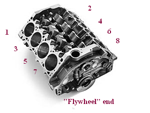

Bcclew, did you get the answer you're looking for? If you are standing behind the engine and facing the flywheel, number one is the furthest cylinder on your left. Not advisable to say port side in case engine is spun around in a v-drive application. Clear as mud?!!
Nothing strange there Rick, been working on mopars since the high school days. #1 has always been there for me, big and small block!
Dave, I believe that you missed my point!
What I meant was....., your image displays #1 in the same location as do the images in my posts #6 and #21.
It was a little more sarcasm for greasemonkey, who is apparently still having difficultly with this!
Oh well! :D

Here is yet another image by Dave, just a few posts back.
attachment.php
If you are Hell Bent in believing that #7 is actually #1, then you'd best perform a PPS on #7 as a means of determining the #7 crankshaft angle @ TDC.
Then re-mark the harmonic balancer as to reflect this!
You can now make #7 your theoretical #1 for ignition timing purposes and build your firing order upon this.
Your firing order will now be 7 2 1 8 4 3 6 5 .... and you'll actually be strobing #7 when setting BASE or TA.
The Engine will not know the difference!
