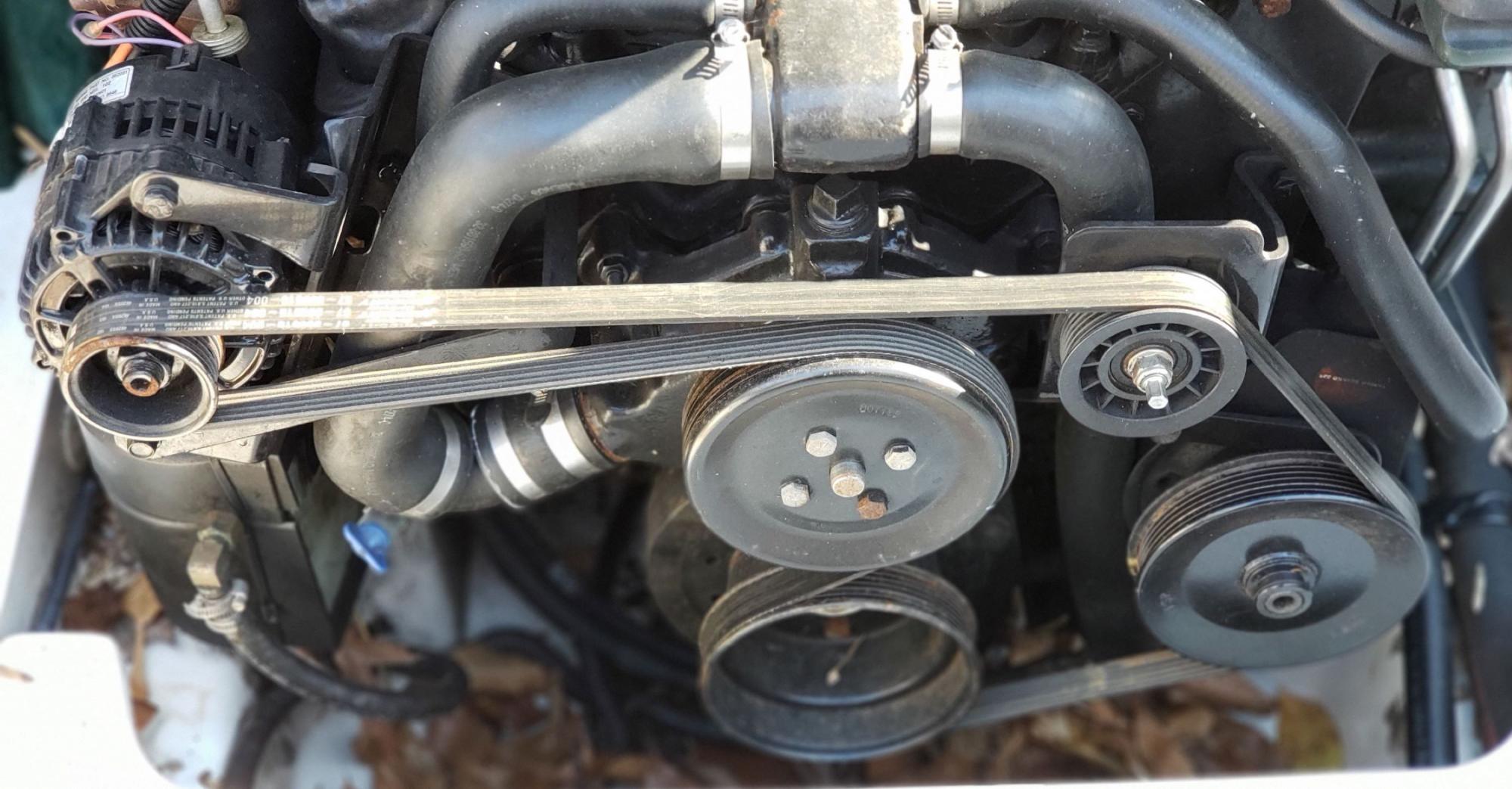

A few months ago, I changed the serpentine belt on my 2001 MerCruiser 5.0 260hp EFI. It is sitting on the trailer and the "ear muffs" are connected to a garden hose. This is the first time I've started the engine since that change.
It fired up nicely and I set the RPMs to 1100. Water is spraying all over the place, mostly because the rubber cups are not making a good seal against the sterndrive body.
The temperature gauge took 5-10 minutes to get up to 170F, then settled back and stabilized at about 165. I assume this is because the thermostat opened.
I am hearing a mid-pitched whining sound coming from the engine but I am unable to determine the exact source. It could be the water pump, alternator, belt tensioner, or something else.
The battery gauge stayed a little over 12V, maybe 12.7

My questions:
- How do I know if I have the correct tension on my serpentine belt?
- Could a belt that is too tight, or not tight enough, cause my whining sound?
- How can I diagnose the source of the whining sound? Might it be normal?
- Are my battery and temp readings fairly typical?
- Are the earmuffs supposed to seal so that no water sprays out? Do I need to buy a new set?
- If the earmuffs are sealed tightly against the sterndrive body, where is the water supposed to exit?
Thanks for any guidance you can offer.
