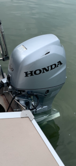

I don't have power anywhere to the dash or trim. I check the fuse box with all fuses testing good. This is with the battery load tested good and positive breaker jumped. Any thoughts would be appreciated.

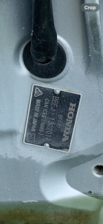

The wires are isolated now but the bl/w wire is not easy to contact. The bl/w wire goes to the green plug but I haven't been able to disconnect it yet.

I need to mention how this came about. Boat sat for a few weeks and when I went to use it I trimmed the motor down and it sounded like a lot of arcing and it went down slow before everything quit.

Meanwhile, it's obvious that the wiring diagram doesn't exactly match the outboard.

Based on your hearing arcing when the outboard was trimming down, I suspect that where that wire goes out the outboard and up to the console is where it may have failed.
Check very carefully where the wiring from the remote control enters the outboard for any signs of chafing or cracking.
That wiring harness goes through a grommet where it enters and the issue might be hidden from view due to the grommet or the insulation of the harness.
Keep in mind though that, when an outboard trims up and down and, in addition, turns left and right, there are MANY places that the wiring harness will flex.
Look with that knowledge for signs of deterioration in any place you suspect that could be happening. It's surprising where a "stress point" will be sometimes.
