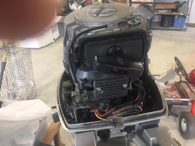

I am adding pictures of the engine so you can see what I am working with. If you see anything alarming, let me know!
I really need to get going on this over the winter. I got a little 16' aluminum v hull to buzz around the creek in. It has a Mariner (Tohatsu) 9.9 4 stroke, but the Honda will give it a little more zoom.
Happy Holidays and thanks to all, Bruce

Well....it certainly looks like everything is is there and in place.
The only thing I might be wary of is that you want to use it on a 16' aluminum boat.
It's a long shaft outboard, probably meant for a 20' + sailboat, and a 16' alu hull just doesn't provide enough height to get it mounted properly.
That a you say you want to operate in a creek. I'm thinking you will probably run into some "clearance" issues with debris or the bottom from time to time unless you keep it extremely trimmed in the up direction.
You might build a transom height extension to get the prop position correct but doing that will surely interfere with how easy the outboard is to operate.
Another option is to get her going and sell or trade for the (short shaft) outboard that fits a 16' aluminum run about.
Either way, most problems seem to get dealt with by clever people. Regardless of how you go about it, I wish you the best of luck!

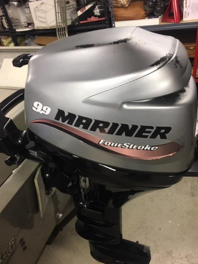

The tin boat has a 20" transom, so I am good on that. Picture of boat (with power washer) and 9.9 Mariner 4 stroke attached.
Not sure where you live, but I get that "creek" brings up different ideas.
I am on St. Jerome's Creek, near Point Lookout in Southern Maryland. About a mile from my dock there is an inlet that goes directly into the main Chesapeake Bay. Picture of the dock (during some coastal flooding) and the creek attached. To give you a sense of it, also attached is a picture of one of my neighbors landing his sea plane in the creek off of my dock!
I figure if I can get the Honda running, I have lots of options. To sell it or the Mariner, depending on how they are running and fit the boat, or sell both and buy another engine. Surprisingly, the boat is rated up to 40hp! That seems a bit much to me, but I could see zipping around with a 20 or25. Just going to stay in the creek and fish and crab, or run out to the inlet where there is a beautiful beach.
