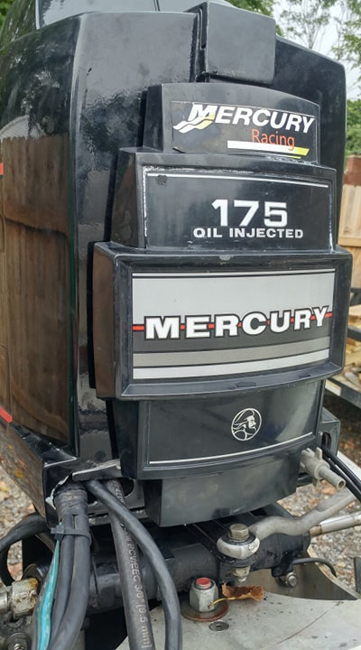

Hey guys and girls. I recently picked up a boat with a 175hp 2 stroke Mercury Racing oil injected motor. (oil injection is disconnected and oil is just mixed in the gas) I have no Idea what year (older) as it doesnt have a serial number sticker. (motor was repainted at one point). I am a gear head but I am a noob when it comes to outboards

Its a Frankenmotor...it a Generation1 2.0L block on a 1984 midsection. If a 175 block it has a different exhaust and if adapter plate wasn't changed it will suck water in the bottom 2 cylinders.

1) Gen1 blocks have no casting for oil injection pump....yours don't either so it old style motor.
2) Its had newer 80's components added on. Most likely a 84 150 that blew and a old style powerhead installed.
3) If it is a 175 block the exhaust ports will not match up and will water intrude the bottom cylinders (milky/water drops) on plugs
4) Look on block behind throttle arm and date will be stamped on it plus where block halfs meet it will be stamped with a 7 for 175, 5 for a 150

Awesome that is some great info! So it does have a 5 so its a 150 block. So that means I really have a 150hp motor here? someone just put the 175 cover on it? I did look at all the plugs and the bottom two showed no signs of water in the cylinders.
Also what is this thing?
Yes its a 150 with 175 decals...look behind that arm on block and you will see date made. The "can" is your enrichener .
If you need parts order/look up 1986 150hp parts, If you need block parts lookup 1977-80 ser#4868998-5503246. Its a 150 .....
