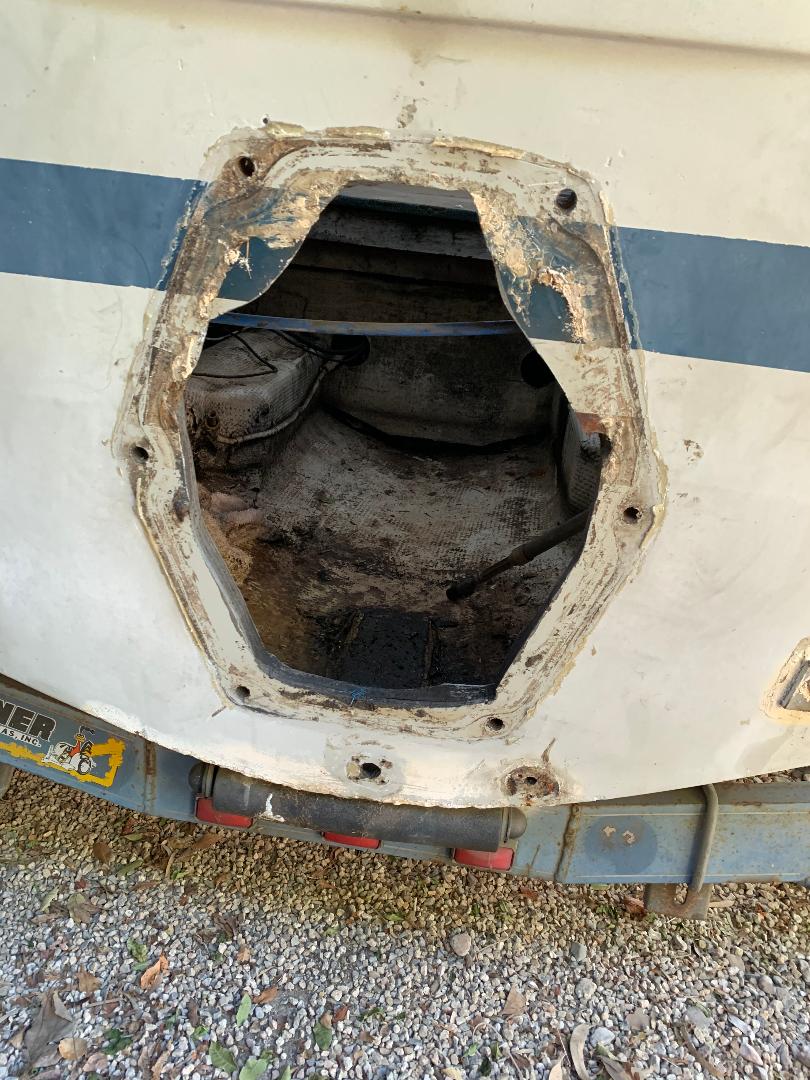

To me, it appears the engine to transom mount pattern is circular. Here is a photo of the transom bolt pattern. I'm interested to know what crate engine I can use, if I decide to go that route. Thank you.
That would be your "transom shield" mounting/bolt pattern. The transom is the AFT most hull component that the "transom shield" mounts to.

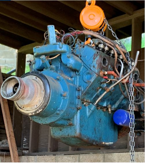

Here is a photo of the existing connection between the sbc 350 engine and the VP 270 outdrive.
ChrisCraft was known to do the Flywheel Facing Forward installations. This means that the front of the crankshaft, crankshaft key way and key are being asked to perform the PTO (i.e., power take off).
The SBC crankshaft was never actually designed for front of crankshaft PTO.
I would suggest going with a conventional engine installation.

The fly wheel facing forward engine’s block configuration is the same as the one that you want to over-haul.
Its the ChrisCraft oil pan and front housing that makes it appear to be different.
