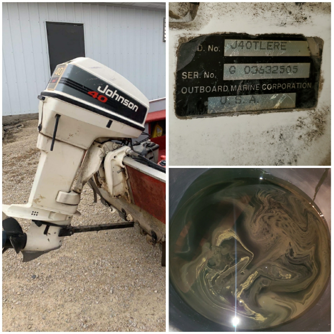

I've included pictures of my boat motor, ID/serial number and lower end gear lube. Please let me know your thoughts, concerns, tips/trucks, advice, order of repair, etc so i can do all this correctly and in correct order.

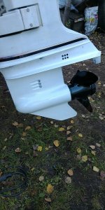

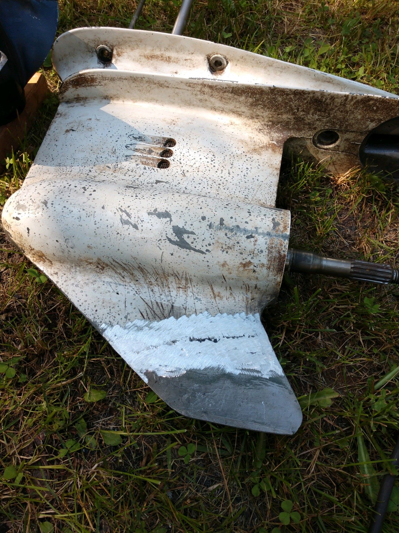

Yuck, water means a pretty good leak. Motor has been abused looking at the lower unit. Skeg is half gone. Low compression could be in part the gauge you have, or a slow cranking too. Do you have the spark plugs out and a fully charged battery providing a nice fast spin. A close up picture of the powerhead would be worth a thousand words. Using Amsoil Saber is a great idea but introduced to the VRO system it would be giving you more lubrication than you need. These vintage VROs are calibrated for basically a 50 to 1 oil. If you want to run Saber then I would recommend disconnecting the VRO and pre mixing to 100 to 1. I run 64 to 1 in my older outboards and all air cooled equipment like weed eaters and chainsaws. My guess is that you will find some cylinder damage and you should probably remove the cylinder head and give a visual inspection. Of course an inspection can also be accomplished by removing the exhaust cover however the head gasket may be getting bad anyway. Check for discoloration of the white paint on and around the head and exhaust cover. Certainly a "red flag".
Here is a before and after of a lower unit I did last season. This is a used skeg welded in place on the original lower unit.5798_compress76.jpg5252_compress65.jpg The prop shaft was not bent but you might want to check yours. It has had plenty contact with rocks.

Heres the pictures. 3 groups of 3 as their to big to attach individually. I am curious what the reddish brown oil is on the top of the "fin". Did i overfill the gearcase somehow? Powerhead to me looks good but im not exactly sure what i need to be looking for. If needed i can get more pictures tomorrow.

Water pump is easy and highly advisable to replace if you don't know the age. DO NOT wait on the gear lube. From your picture that is badly contaminated. While you have the LU off you should run a leak down and vacuum test to see which seal is leaking. Evinrude HPF gear oil works great.

If there was water in the gearcase I would take it apart now.------These gearcases are NOT robust.-----Some will argue but I have seen a few sudden failures with teeth ripped of the pinion gear.-----If gears and bearings are good then install new seals and pressure test..
Looks like head gasket has already been replaced. If that's the same oil that you put in the gearcase it shouldn't have gotten out unless you have a large leak above.
You can use as is but your prop now has very little protection. As it is more exposed a rock strike could more likely bend the prop shaft. A GOOD EXPERIENCED mig welder can repair it without even removing the gears if everything else checks out.....do a quick pressure test and then evaluate. You can get a skeg section cut off and sent to you from Tim's Outboard in Hackensack Minnesota phone 218-682-2331 ask for Mike or Dan. Probably 20 or 30 bucks.
It's best to use cast aluminum for this repair as the properties are exact to make the perfect weld. That's why I recommend bringing the part right to the welder....bring him a used skeg to weld on. Many repair shops use "wrought" aluminum which is a different alloy and gives a second rate repair. I have done "wrought" repairs with little motors but the bigger motors have a taper and is hard to get the shape correct. Strength is also a factor. If you have him rough it out like in my lower photo, then you could save money by grinding, sanding, and painting it yourself. Probably will charge you an hours labor which could run $100. The repair you see above with new shaft seals, not including the prop repair, cost the customer $250 with an epoxy base/clear finish and new water pump impeller and grease. The lower unit in my photo also had a bad hub in it's damaged prop, so I scrapped the prop and repaired another I had in stock which was better suited for his pontoon boat....same diameter, but a little less pitch. Pitch is determined by calculating how many inches the prop should travel with one complete revolution.
If there was water in your gearcase it needs to come apart for inspection and new seals.------Pay now or pay a lot later is the concept here.
Racer is correct. If water was mixed in long enough it can cause the gears and even bearings to get rust so it should be dismantled/inspected. A certain amount of pitting from rust can be tolerated, but an experienced tech should be consulted....
