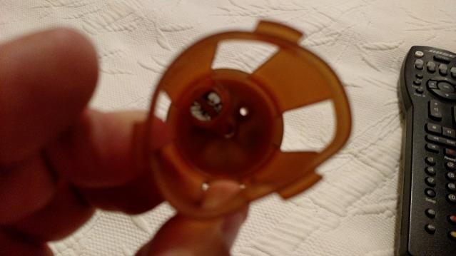

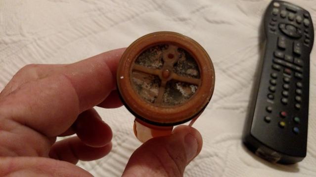

This is what I found in my fuel pump strainer.
Hope it works out, let us know..btw I know these issues from my own previous experiences with the hondas..keep us informed
SO water tested boat last night for few hours she ran awesome !!!!! back to 100% as you can see by pics cleary was issue thanks again to all hope by sharing will help others
