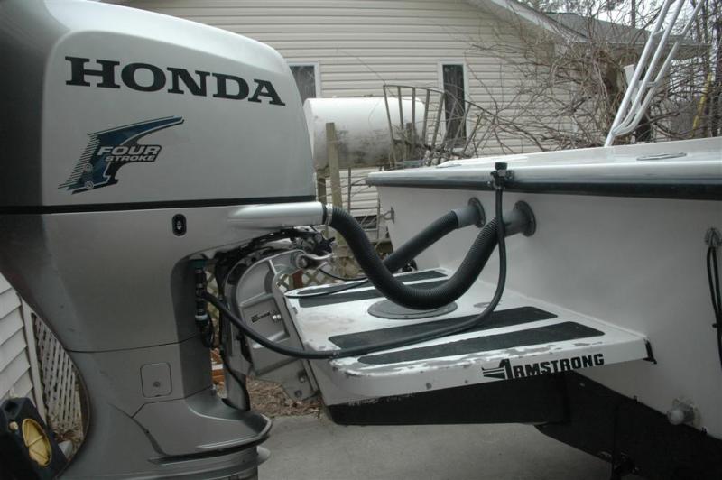

Here is a modification to the Honda flushing system that easily allows me to flush the engine from inside the boat while it is on the lift or trailer. It is very simple to fabricate using 1/2" automotive heater hose, a 1/2" T connection (West Marine has them for on-board water tubing), six stainless steel hose clamps, and fittings for a garden hose. Simply use two very short pieces of hose to clamp on the appropriate male and female fittings on each end of the T connector, then clamp the longer hose to the third outlet of the T and run that to the back of your transom. Fit that end with a garden hose on-off valve and a quick-disconnect for a garden hose. I anchor that end to the back of the transom with a stainless steel snap clamp.
