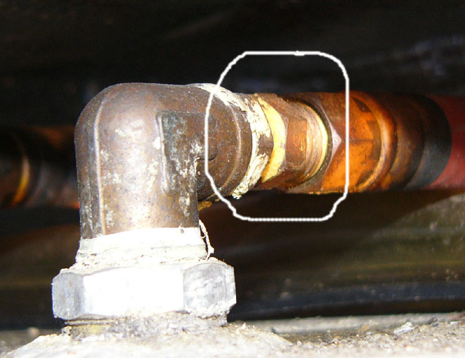

test of adding a picture worked ffine for me.
lets try again. Nope no luck. What was your procedure?
I opened a reply to thread box.
Clicked the insert image box.
Picked a file from my download file in my computer.
The file uploaded. I watched its count down.
Then it said waiting for Marineengine.com. After about 20 seconds it finished no other messages. No picture.
I just checked on the Reply with Quote then Go Advanced. Then under the Additional Options clicked on Manage Attachments to open the File Upload Manager. Go to the folder that contains the file you want and drag it to the lower section and click the small check box under the photo and then click the Insert Inline button. Voila your photo should show in your post before you even click Submit Reply. I don't know if there is a size limitation but my file is fairly small ...85 KB anti-syphon2.jpg
