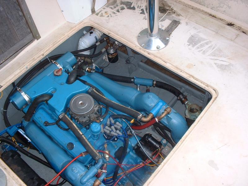

The only thing keeping me from upgrading is the intake manifolds. I haven't seen any of the newer ones that have a profile as low as the old ones on my boat. I currently only have about one inch from the bottom of the closed deck hatch to the top of my flame arrestor. I dont want a raised deck or hump to accommodate a higher rise on the intake manifold.
Good morning
Could the two intake manifold outlet ports be closed off .... followed by installing a later style T-stat housing?
attachment.php
You say that the intake has a blank where the thermostat housing would normaly be, sounds like the intake on my engine. except mine is a closed system and has a reservore where you have the housing. interestingly enough, My engine has no thermostat at all and no place to put one. I see on the right side of your engine you have a hose that looks to be 1 inch and goes down under the engine, what is that?
Also I am using a Rochester 4jet carb (1967 vintage) as the intake is a square pattern and the holes are all the same size. Like you I can't put a taller intake on due to height.

The lower tstat housing with the bridge to connect to the 2 out flow ports in my intake manifolds. This is the piece that my low profile intake manifolds need. Part is looong gone. I could possibly have a line on 2 used ones I should be getting a call back tomorrow. At what price????. Have some very plausible Ideas to mimic The original part. Wont be pretty but should work.
Anyway put everything back together with thermostat even though it is bypassed. It is in the condition that I have been running with since I bought the boat used 12 years ago. Has always run good. Just very cool.

Looks like your source in Europe has two locations, one being in the UK....From what i read, it could be their version of the NLA Crusader housing....so it may be worthy of a premium. I would compare it to whatever your costs would be to 'mimic' the original....I wouldn't think it difficult to bore two holes and tap them....clearance would be the only concern...That 'bridge' in the original style appears to connect to the head coolant ports - is the intake 'short' (front to back) to permit this??? or does the intake just provide a 'pass-thru' on the flange and the bridge sit on the intake?
The intake is full size with pass thru on each side at the coolant ports
Never seen a standard production cast iron manifold without the coolant passages/tstat 'neck' .....
another option (no machining required) would be to remove the NPT sensor and install a TEE fitting and any adapters required to connect the open ends to the coolant passages coming from the heads....if you can't relocate the temp sender fitting to another existing hose, you could add it to the top of the housing....
Is it ok to reduce from 1-1/4 inch hose ?
I don't think it is optimal but it will be functional....you can always add another NPT hole, for the other hose, to the other side of the housing....either way, i don't see how you can do it without a 'reducer' fitting which will induce another pressure drop....which I don't see as a big issue because its a low pressure system to start with and, once the thermostat opens, there's not much of the system left to traverse....
FWIW, I've seen many mercruiser engines and a few custom ones that use 3/4" ID hose in the same spots Crusader uses the 1.25"ID hose....w/o any issue at all...
