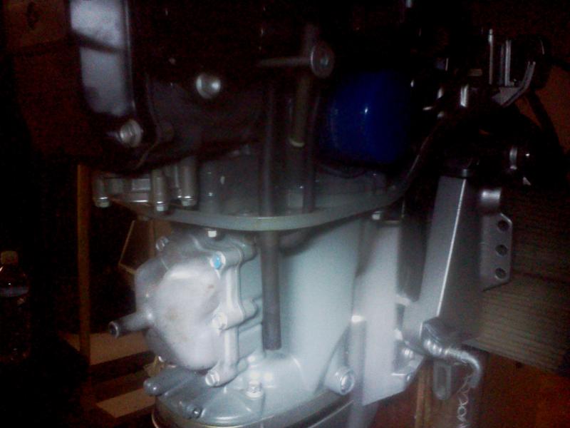

Just purchased a 2002 BFP9.9D Elect start-Remote XL shaft
I took the shroud off after not seeing any water coming out of pee holes. There are no lines connected--in fact I don't find any lines at all. There are 2 lines dropping down from the plastic pan next to the flywheel over the rear timing belt sprocket. The lines are on each side of the engine and placed in the proper holes. One line will reach but the left side line is only an inch below metal holding hole. Also there is an open screw hole above what I think is the thermostat housing-located behind the started housing. Inside the hole there looks like a plastic black shape in a +. So, I'm starting to worry about my purchase from a Honda employee who said the motor was fine and pumped water the last time he started it-ya right. My plan is to replace the water pump given the previous owner said it had sat for 3 years. The motor started up even with the old gas in carb and seemed ok after running new gas through--yah the carb will need a thorough cleaning to fine tune it asap. What have I gotten myself into. Please see attached photos. :cool: 001.jpg002.jpg003.jpg

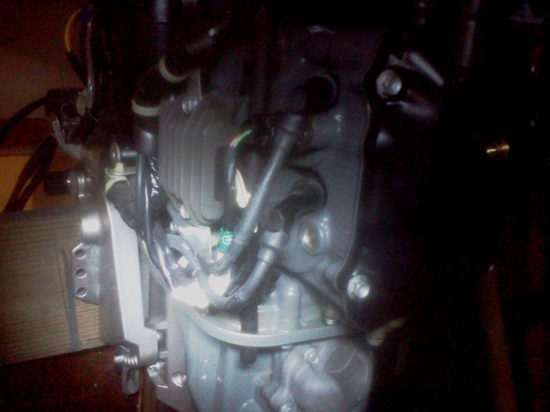

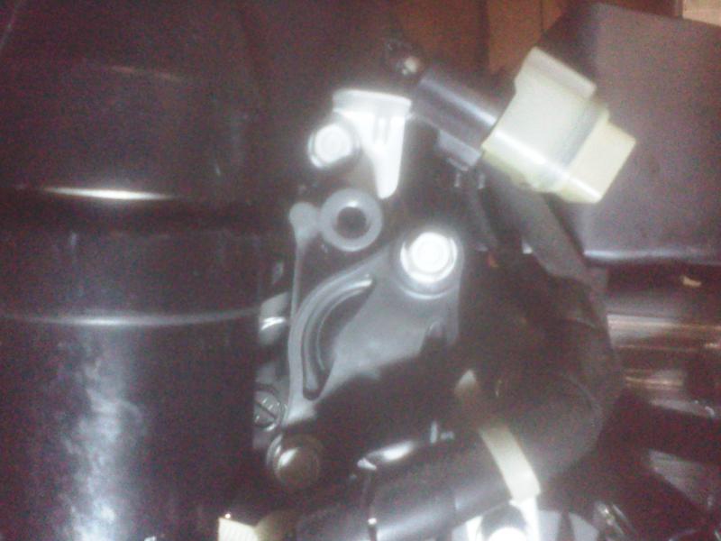

Your first picture is of the thermostat housing. The hole you mentioned is the flush port.
I think i can see the water discharge hose in your second picture. it is the black hose closest to the oil filter. It comes up through the opening, then it should connect to the indicator nipple on the side cowling. The other nipple that you see in the cowling is for the carburator float bowl drain. It should be a clear plastic hose.
You may want to try to blow some compressed air back through the black indicator hose. Most likely, as it was sitting, small critters got in there and built some nests or just accumulated some debris.

2. The thin black hose next to the oil filter goes from bottom of carb into the side of the muffler.

In your second photo...isn't the black hose in the hole nearest the oil filter connected to the side of the engine? It SURE looks like it is. If so, THAT is your pee hose and it is connected properly to the engine and just needs to be re routed to the stbd side cover plastic nipple. If it is connected any other way and has water coming out of it, it could feed water into the engine! Straighten that mess out before worrying about anything else.
NOTE: that pee hose MUST come off of the nipple in the block and then go up, THROUGH THAT HOLE, in the "drain pan", and then out to the nipple on the side cover. If you route the hose to the side cover without putting it up through that "pan", then the hose will be pinched closed when the cover is installed and tightened down.

The flush port is just that, a valve port to flush out the thermostat housing. The threads you can see in the hole are for a special garden hose adapter to screw into that housing and apply water pressure. Do yourself a favor and don't use it. Flush the engine like Mike indicated by running it in a trashcan or test tank. The flush valve just doesn't seem to work all that great and it will begin leaking if you insist on using it. Don't worry though, if it leaks, it is easy and cheap to replace the components and you should replace the thermostat and internal anode every couple of years anyway.

This is what I found out today. The thin black rubber hose that comes from the block behind the muffler was actually plugged into the bottom of the carb. I removed it and placed it onto one pf the pee ports. Then took gas line and went from the bottom of the carb to the second pee port. feeling better know. This engine was run with muffs and now I can see why there was no water coming from port. Could having the water line hooked to the bottom port of carb done and damage--seems like that is a one way valve. I blew out the water line and felt some resistant and then it opened up and I could hear air coming out the lower end. Should I fire it up with new plugs and see what happens or could there be water in the engine??? The oil looks fresh and I don't see any evidence of water on stick. Previous owner did oil change prior to storage 3 years ago. Let me know--your ideas have helped so far.

Maybe this will help. Look at the thermostat housing parts blow up link below and note that parts 2-3 & 4 are the flush port check valve pieces. There is NO bolt associated with the flush port hole. All the bolts listed are either labeled #10 for the thermostat cover or #11 for the thermostat housing flange. http://www.boats.net/parts/search/H... SHSA VIN# BABJ-1100001/THERMOSTAT/parts.html Yes, I know it has threads and, yes, I know it's tempting to want to stick something in that hole but it is not necessary. The threads you see are for the flush adapter.
