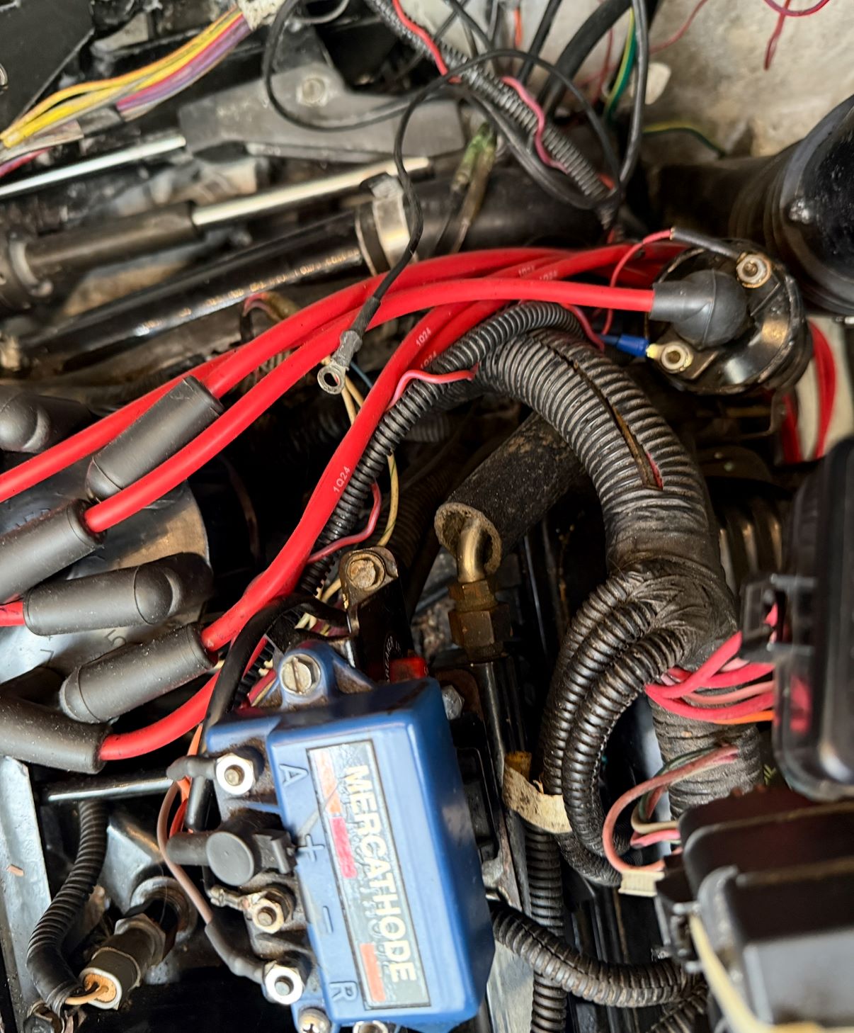

By the way, there is a ground cable coming from the engine and I have no idea where it goes. MAybe this could make the difference as well? The lenght could fit to the coil or mercathode... but cant see any point to connect it. Unfortunatly the file upload is not working - i will try again later.

here we go.. this is the ground cable comming from behind the motor

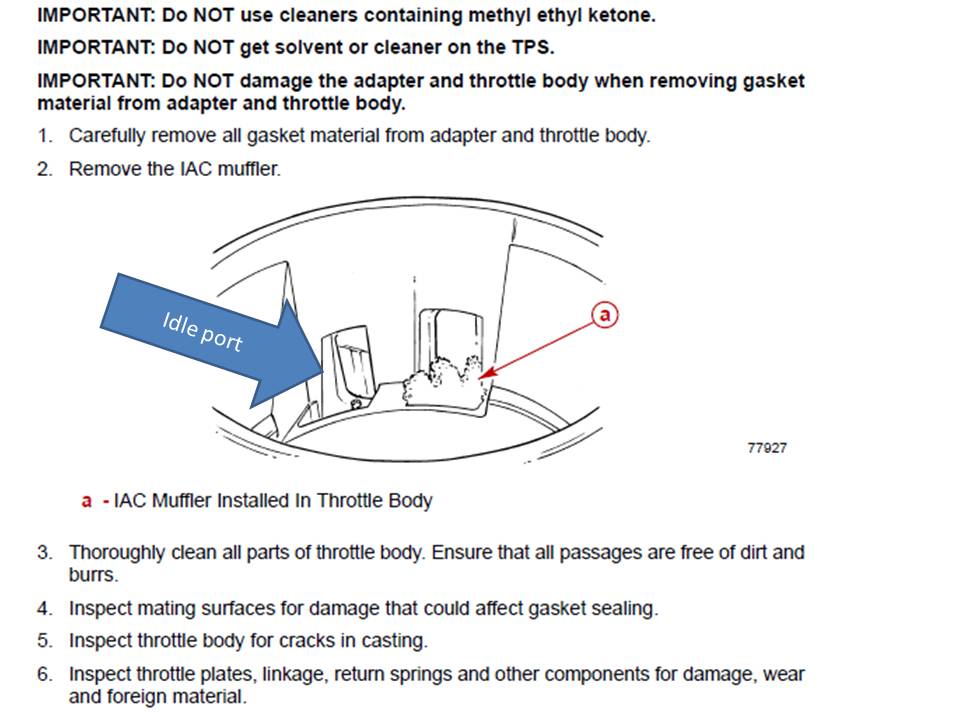

when I cover the bypass in the throttle body the idle goes down but still not stable. So my thought was that maybe sth. is wrong with the signal/ information the ECU gets. And since the whole system ran a bit hot because of the broken impeller could it make sense that the cooling temperature sensor is damaged and sends rubbish?
When I cover the bypass where IAC gets the air from the motor turns off immediatly.
Covering the idle port causes the motor to idle down but not die gives me more reason there is a vacuum leak somewhere.

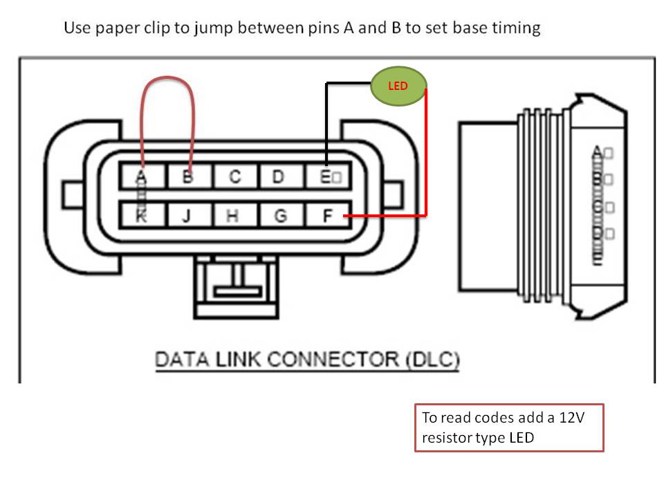

The Data Link Connector (DLC) is normally near to the ECM but can also be near the thermostat housing. It has a black plastic cover which snaps off to expose the pins. Jumping pins A and B puts the motor in "base timing mode". When oins are jumped the MEFI-3 ECM stops adjusting timing
Edit: The mechanic wanted to bypass the ECM after adjusting the ignition timing, which was apparently possible on older models. According to him, the control unit would otherwise have immediately re-adjusted the ignition timing again. He couldn't bypass anything on my control unit – could that be related?
Putting motor into base timing mode is probably what your mechanic mentioned.
So was the mechanic not able to find the DLC or was it found and jumping A and B did nothing?

A jumper "must" be installed to even begin to set timing, it has to be in base timing mode to set correctly.
If timing was done any other way than it is not correct
How to set timing. I edited for your ECM specifically
1. Connect timing light to number 1 spark plug wire.
2. Start engine and run at 1300 rpm until it reaches normal operating temperature.
3. Stop engine and connect "jumper" to the DLC connector
4. Start engine, allow rpm to stabilize.
MEFI-3 models only, ECM will automatically adjust engine rpm to approximately 1200 rpm when put in the service mode on a scan tool or when using the timing tool or jumper.
5. Check ignition timing. If incorrect, rotate the distributor until timing is correct. Torque clamping screw to 18 lb-ft (25 Nm).
6. Recheck ignition timing.
7. Disconnect scan tool or timing tool or jumper from DLC connector.
8. deleted
9. Restart engine, increase rpm to 1300 then return to idle position slowly. Ensure that
engine returns to idle rpm. Readjust throttle cable, if required.
10. Shut engine off.

You can connect terminals A & B with a paper clip, jumper wire for a meter or other wire. This is at the ALDL (Assembly Line Diagnostic Link) and you would use the Check Engine Light to see the codes, but it also serves to go into diagnostic mode, for setting/checking timing. You'll need to increase throttle to 1000RPM for this and you'll be setting BASE timing. The reason I used capital letters is because the timing will be fairly

In your first post, you mentioned the unconnected ground wire and showed it in a later post- what is at the other end?
Did you or the mechanic connect it to the block? If so, what changed (if anything)?
Put your hand over your mouth & pinch your nose- how well can you breathe? Think of the throttle plate as your mouth and the IAC as your nose- those are the only ways for air to enter the engine, or should be.
The ECM uses MAP and RPM to 'know' how far to open the IAC- above 300 RPM, TPS is used when opening/closing the throttle quickly ±20% and it's also used to clear a flooded engine (open throttle to WOT and crank).
The fact that it draws air into the IAC orifice doesn't mean you don't need to do a vacuum test- each cylinder needs good vacuum in order to draw the correct amount of fuel and air into the cylinders. IAC is there to allow the engine to start and run without opening the throttle, add air during hard acceleration or close during hard deceleration.
The IAC is called a 'stepper motor'- it opens & closes in discrete increments and in the program, the ECM closes it after the engine shuts off, then opens it a specific number of steps (that's called 'parking' or 're-parking' the pintle), which allow it to start. If that changes (the pintle stays open too far or not enough when it parks, RPM will be too high or low, respectively.

@jimn the ground wire is connected to the block on bb rear side of the motor - so no idea where to connect. I was hoping someone else with this early MX 6.2 here in the forum who could check his wiring scheme...

I'm not talking about the IAC hole inside the Throttle body (TB), I'm talking about the holding the throttle plates closed by hand. Remove the throttle cable from the TB arm and use fingers to push the arm on the TB closed, Does this idle it down?

The black wire might go to the transom assembly to connect the anode corrosion circuit… see if there’s a black wire from the rear of the engine block to the transom housing ‘often found on the port side of the boat… if not, and wire is to the housing, try posting an overall picture of the whole engine area as maybe it will help ring a bell… since there is already a negative black wire on the mercathode, it probably isn’t the one though it looks close to it in design.

Transom is connected with a ground cable - connected to the same block where the lose one is coming from
We have no diacom so I need to get in touch with still active service companies - my mechanic retired and seems that he run out of ideas now. I connected a 12V Led to the DLC - no codes to see. Just during the A/B jumper setting before the start it flashes 3 times every 5 sec. (ignition position). After start to blink.
What is "connected to the block on bb rear side of the motor"?
The light flashes once, short pause, twice and repeats three times, right? That's what you should see and it's the way it shows the number 12 and it's the beginning of any codes that were stored. After the codes have been displayed, it will flash the same 12 code to indicate the end. Now, count the flashes between. The attachment shows MEFI codes and what they indicate- don't worry about the numbers at the end of each line, those are just the page numbers in the manual I have.

BTW- if you want to measure vacuum, look at the base of the throttle body for an unused port- it may have a rubber cap. You can also use the PCV hose with an adapter- remove the PCV valve, attach the adapter for the vacuum gauge and start the engine for the test.
