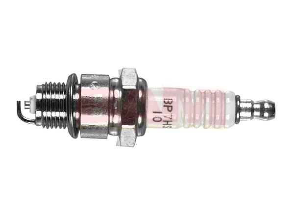

Look at the boat's registration- I don't know if other states are the same as Wisconsin, but the engine/drive model and serial numbers are on that. You need to refer to the Mercruiser serial numbers, nothing else. In post #46, I showed the serial number ranges and if yours is actually an '89, it wouldn't have the MR43LTS.
'87-'89 3.0 L uses 59571 and 898264001, shown in the Mercury EPC. That crosses to NGK BPR6FS.
MR-43LTS photo- shows much longer threaded end-
MR-43TS photo-
NGK- BPR6EFS
