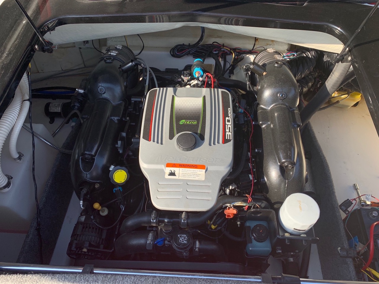

Hi All,
I have a Glastron GTS 225 with Mercury MPI 350 5.7L B3 Inboard, Yesterday during my boat trip had the Manifold completely exploded as per the pic, I could not share the video taken during this explosion. Did anyone experienced this with they engine ?
This engine is well maintained and flushing it all the time with Salt Away product.
If anyone had this on the same engine I will be very interested to know if they find out the cause of this.

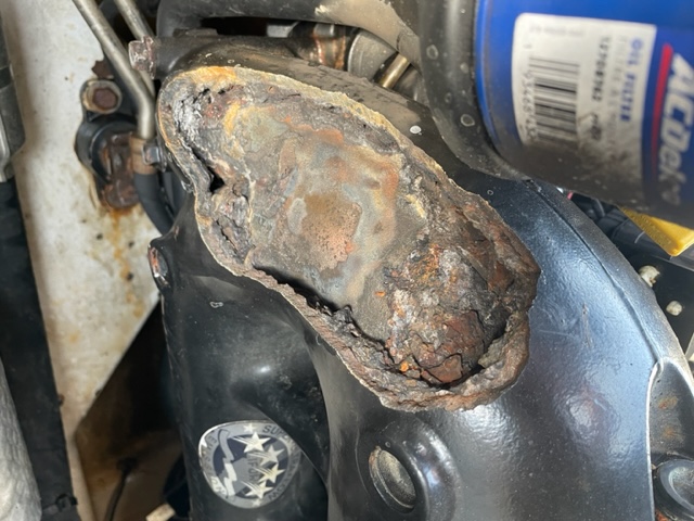

Ayuh,..... Are those cat. conv. manifolds,..??
If so,.... My guess is they needed replacin', Last year,....
So the outer casing cracked off ? was it not properly winterized and cracked? From the looks of it the inside exhaust wall is ok ? is that correct?
Yes only the casing cracked, it was properly winterized but I am suspecting the flushing kit of mercury, I have the feeling The Salt away product don't go properly between the inner and outer casing.
What Kit are you using on yous Mercury MPI350 5.7L ?
The Salt away goes where the sea water goes... Possibly there is an internal blockage in the elbow that prevented proper flushing and also resulted in overheating and steam buildup.
Yes only the casing cracked, it was properly winterized but I am suspecting the flushing kit of mercury, I have the feeling The Salt away product don't go properly between the inner and outer casing. What Kit are you using on yous Mercury MPI350 5.7L ?
How old are they in salt water? typical life of 5-7 years. As others have mentioned probably blockage creating a hot spot which could crack it for sure.
Looking more closely, it appears to me that part of the water passage is totally blocked. Its the part at the bottom of the pix ( which is the front of the elbow).... It's possible that this is core material from the casting process that was not properly removed. An EASY test is to take a small sharp object and scrape a small section ( about 1/2") long of the blocked passage to a depth of 1/2 to 3/4"" and inspect it. If it's core material, it will be very uniform and non magnetic. In this case, it's a MERC Q/C issue. It is also possible it is mud from a previous ( years ago??) encounter with a sand bar or mud bank.
