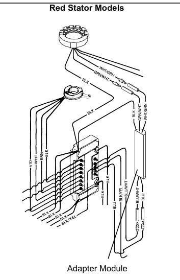

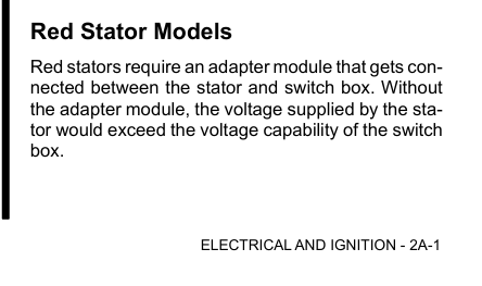

Stators will interchange as both are 4 wire stators. It could be the stator adapter
Thanks, I have a spare one of those I could try. Does this just protect the switch box from excessive voltage of the higher Amp red stators?
Would this being faulty cause a miss-fire / poor running as seen in the clips attached?
Also could a faulty or non-compatible trigger cause this? - Hence the question on if the trigger works with both stator types?
It works as a voltage balancer or regulator
It is possible
Yes a trigger can cause issues but I have never seen one intermittent on a Merc. My suggestion is to take a timing light and find which cylinder is dropping under load. Could also be a carb issue with fuel delivery into carb leaning out.
